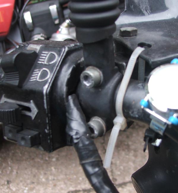

Replacement mirror boss on emzie
Here's the clamp I mentioned in my previous post in this string. Its an easier answer to the problem for most as it involves no thread cutting, its also a lot cheaper than buying a helicoil kit.
