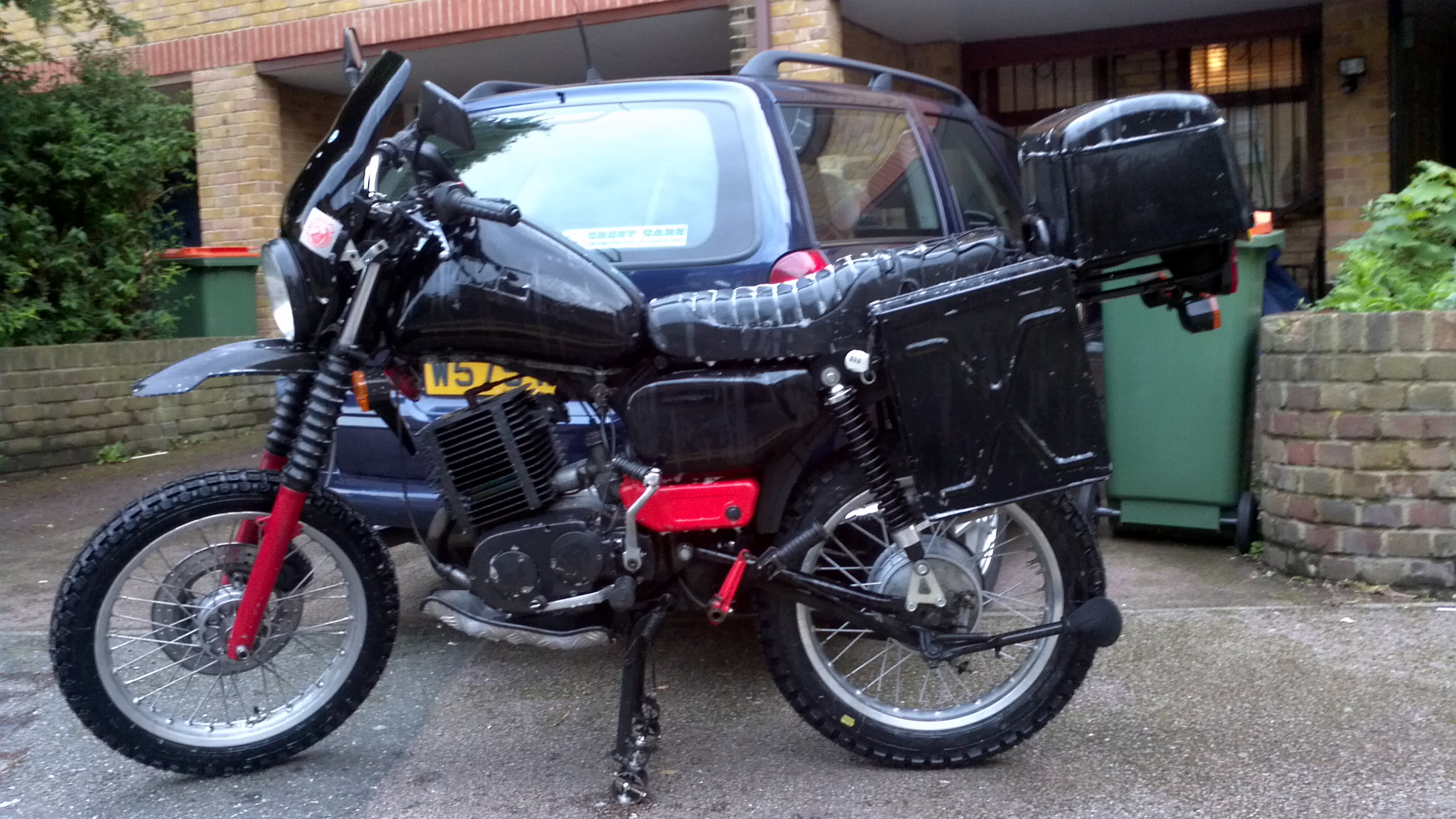

Postby thomaskwscott » Wed Jun 13, 2012 2:37 am
A quick update. Martin at Burwins sorted me out with the 18 inch rear wheel from an ETZ 250. It fits the swingarm but he did warn me that clearance at the top can be a problem (mines lifted 2inches anyway so not a problem). Looks like my maths was a little bit optimistic but the bike seems comfortable in 3rd all the way to 40mph now (this is brilliant for my commute).
I've attached a picture of the new setup (posty wash) showing the most important feature i've gained, it looks mean!!!

Postby radiograf » Wed Jun 13, 2012 12:55 pm
What front mudguard do you have fitted?
radiograf
Posts: 272
Location: Stechford
Re: Correct Rear Wheel Size?
Postby thomaskwscott » Thu Jun 14, 2012 6:24 am
The mudguard is from a '08 KTM 65, bought from Ebay for the princely sum of £4.25. To mount it i used some extra large washers to block the holes in the bottom of the yokes and ran some bolts down. In the end i had to create a 3rd fixing under the headlight to stop it wobbling about but i think it looks pretty good. These MX mudguards are all plastic anyway so a little work with the Dremel and they'll fit anything ;-)
