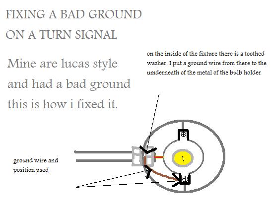

Postby ghostinthemist » Thu Mar 22, 2012 1:46 pm
ok 6 volt 21 watt bulb holders but i can only get the front left to light up? I disconnect the wires and touch the sender to any other bulb wire and no light up? What gives? In other words i can switch the left and right on the switch and as long as its that one light it works? checked connections free of corrosion or decay. Left and right are both getting power sent but cant light up the bulbs. Already put the other bulbs in the working fixture to ensure they worked. Cleaned grounds what next?

Postby DAVID THOMPSON » Thu Mar 22, 2012 4:54 pm
one thing i have found on old bikes
is some times fork neck bearings do not make a very good ground
hook a jumper from battery minus to the handle bars or a ground point in the headlamp
depending on the bike frame for earth ground is not good
a nice good number 12 stranded copper wire from all ground points to battery minus does wonders
for making things work better
can you point me to a link to the wiring drawing that matches your bike ?

Postby ghostinthemist » Thu Mar 22, 2012 9:51 pm
Ok so here's what went down. I ended up noticing that there was in fact a bad ground somewhere but couldnt find it....solution.....created grounds from the bulb holder to the shaft of the fixture holder all on the inside of the lens. Worked great!but i still wonder why i can hit the brakes with the key out and it still lights up. Oh and dave as far as a correct wiring the pictures i have posted in mz ts 150 wiring problems show the correct wiring. I have yet to find a lucas wiring diagram for a MZ

Postby ghostinthemist » Thu Mar 22, 2012 9:52 pm
I HAVE ALUMINUM FORK NECK BEARINGS!!! THERES MY PROBLEM!

Postby DAVID THOMPSON » Fri Mar 23, 2012 9:34 am
lots of bikes leave the brake circuit on when shut down
most of my home wired ones are that way
as for an MZ they seem to dance to a different drummer when the did the wiring

Postby ghostinthemist » Sat Mar 24, 2012 2:30 am
this is how i fixed my problem
