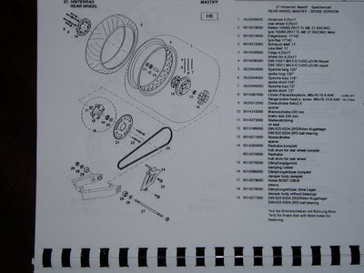

I thought that pictures with the parts listing to the right might be of some help.

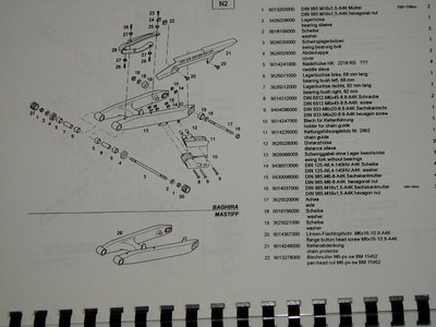

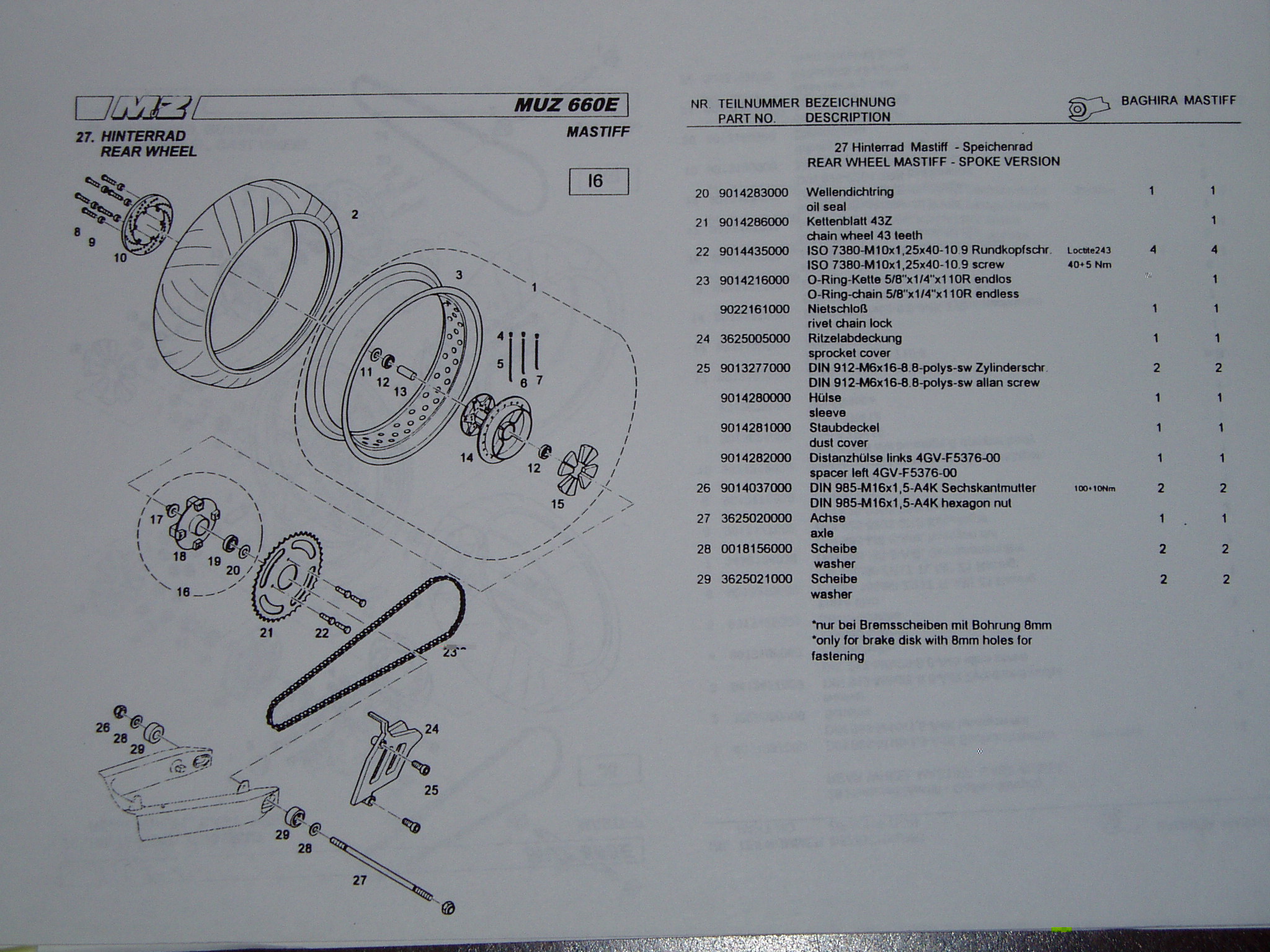

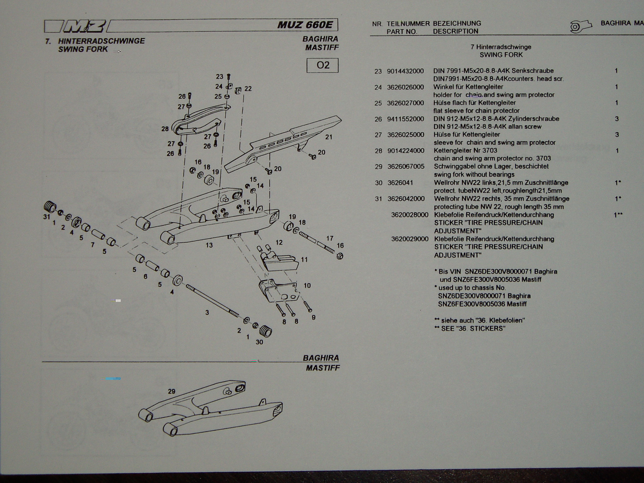

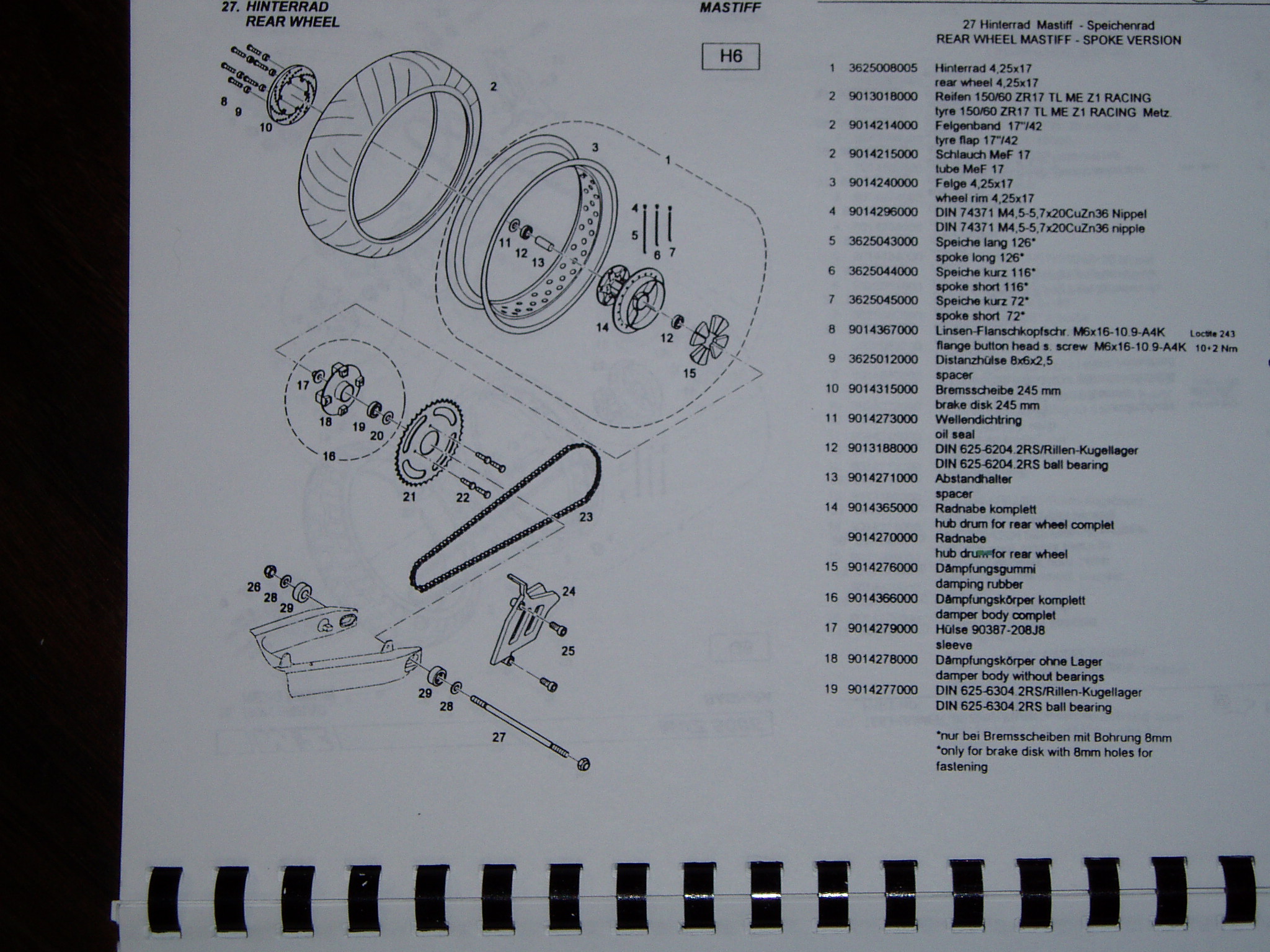

Postby OLDMTNCARVER » Thu Dec 22, 2011 8:50 pm
Here's a couple more.
If you've misplaced something I hope this would help to identify the part or parts you might need.
If you want you can click on the desired picture to make it larger and easier to read or just print.
Please note that I've changed the pictures to the correct Mastiff photos. I realized that the Baghira assembly pictures I had provided were missing the part number section that pertains to the spacers that you asked about.
I apologize for my mistake.

Just a couple of thoughts, is the sprocket carrier seated in the cush drive properly, is the back wheel aligned properly, if its not the rear disc may lock up in the caliper. Do the pistons in the brake caliper need reseating?

You state that the spacer is binding on the bearing seal, is this part 28 or 29 on the diagrams, as these appear to fit on the outside of the swing arm, not inside. I apologise if I'm asking something stupid, but I've never worked on a Mastiff, I'm working from the layout on the diagrams, and remembering the daft things I've done in the past! I recently had the front wheel on a etz251 bind after changing the tyre, turns out the bolts holding the brake caliper onto the fork are two different lenths and I'd mixed them up, locking the disc!
Edit: I've just spent some time looking at pictures of the rear wheel in the gallery, any chance you've managed to fit one of the washers inside the swing arm between the brake caliper carrier, and the arm itself. I refer you to my previous comment about my own daft actions.

I looked at the diagram again and noticed that the spacer I am referring to is not pictured here. Once the swingarm is assembled there are two spacer that fits onto the shaft that alligns the break callipers with the disc. This is opposite to the sprocket. The spacers fits between the hub and the swingarm. This is where I suspect that the wheel is binding as the one spacer is recessed to align with the wheel bearing on the hub, but as soon as you pull the shaft tight the wheel locks up. It just does not run free. I suspect that the spacer on the inside of the hub could be damaged and that it is allowing the bearings to be pulled to close together. But, I am still stuck, I am going to take it all apart again and start over.
