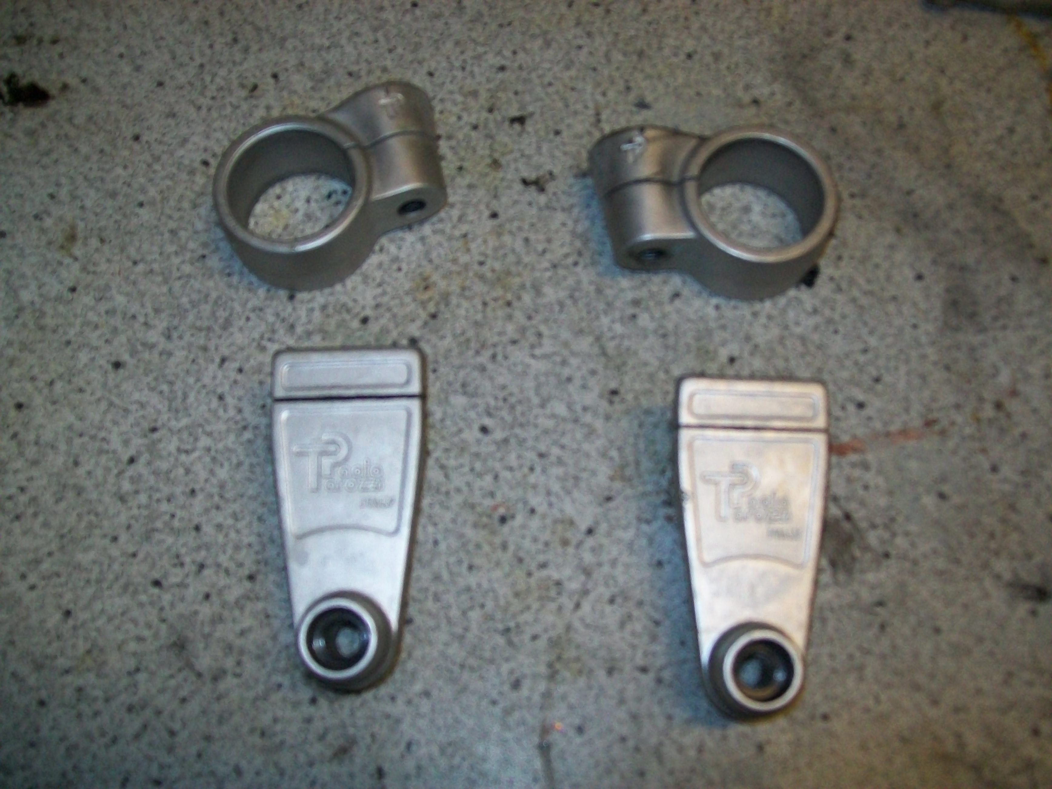

Postby DAVID THOMPSON » Sat Nov 26, 2011 10:12 am
some one posted a link to a how to work on those a while back...
http://www.totalaptitude.com/skorpion/Tarozzi.htm
http://www.tarozzipaolo.com/home.htm
there a wedge fit hold in vice wrapped in shop rag
and slap smartly on the other end with a soft board
do wear a glove and warm the out side of taper with a butane lighter
a little heat BUT VERY LITTLE

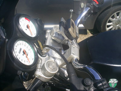

Postby DAVID THOMPSON » Sun Nov 27, 2011 10:08 am
if you break stuff in the process
i included web site for the oem supplier
i repositioned mine when i first got it.
because i can't ride a bike laying down
recycled a set of saxon tour bars but still too wide
the cables were just barely long enough
had to cut the bars in to 2 pieces to fit it together
under the GPS unit note the piece of black gas plumbing pipe to make it all stiff
its all still too wide any one got a scorp tour top tipple clamp for regular bars? in the spares box
DAVE
