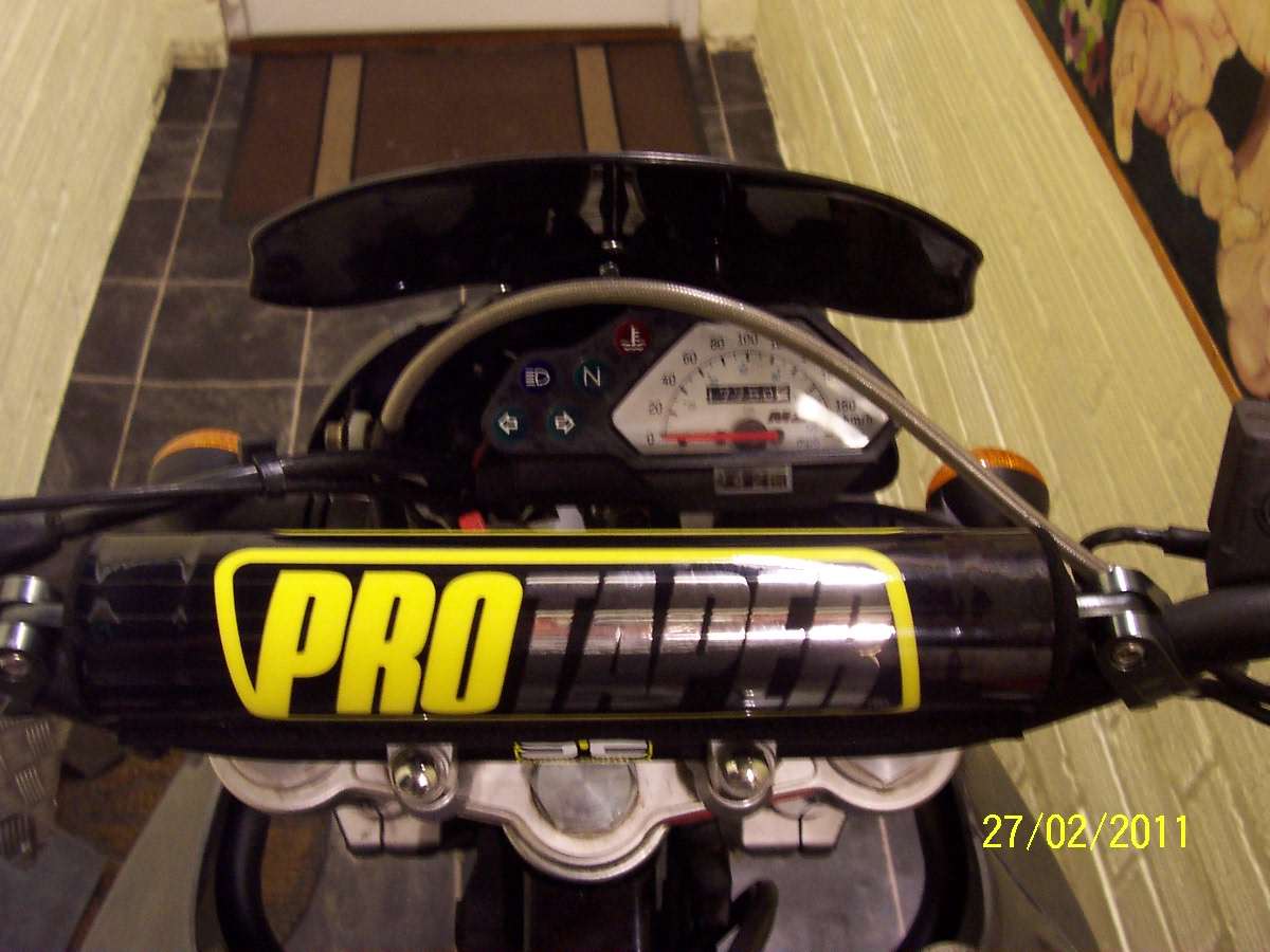

Postby wookster » Sun Feb 27, 2011 4:29 pm
hi cat, edec, heres the pics you requested.

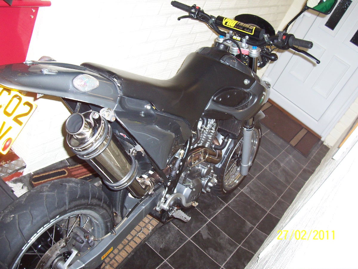

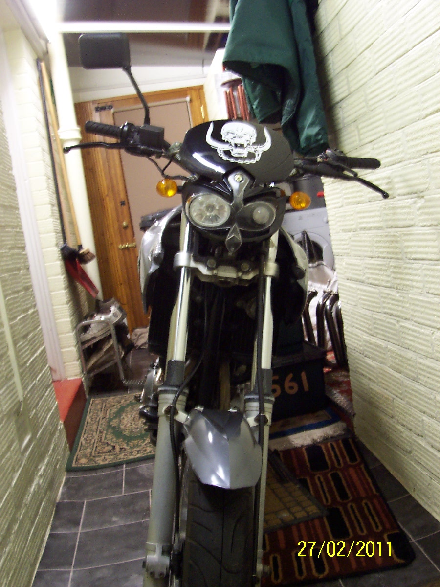

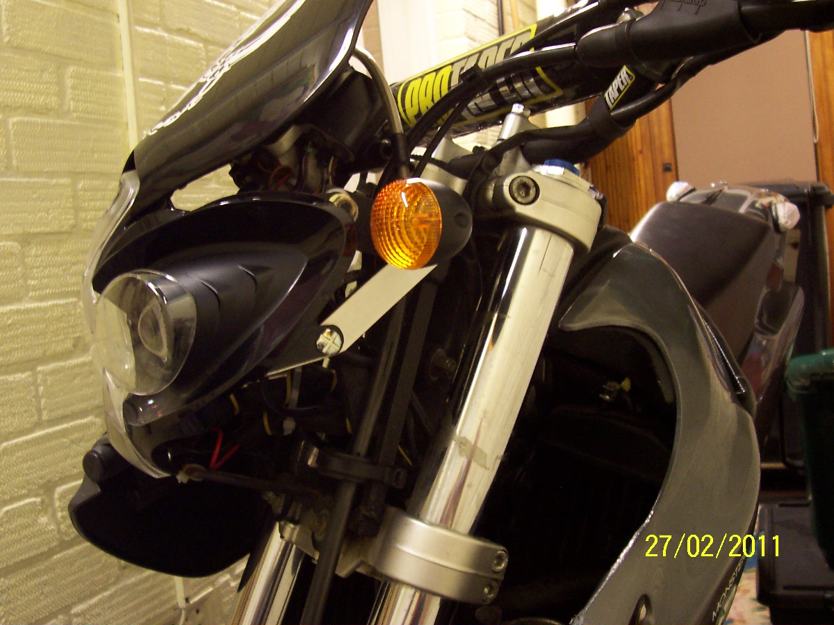

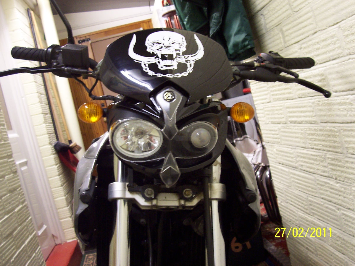

Postby wookster » Sun Feb 27, 2011 4:31 pm
And a couple more.

Postby angustoyou » Sun Feb 27, 2011 5:17 pm
That looks really neat. Does the screen give any more wind protection? Is it stable? And are the lights better?

Postby edec » Sun Feb 27, 2011 8:02 pm
Wow that looks great! Thanks for sharing.

Postby wookster » Mon Feb 28, 2011 3:23 pm
hi folks. yes the top shield is stable. hasnt blown off at a ton yet. the lights in the dark are fantastic. 55w dip on the projector beam is good enough on its own.main beam is great.dont think i get any more wind protection. im 6,2". sorry i didnt put any side pics up of the bike but it was dark out and bike was tucked away for the night.you may have noticed i moved the front mudguard down to the wheel, it was doin F, ALL up under the steerer tube apart from spraying me in the face, works a treat now and keeps the engine cleaner. plus i think it looks better anyway, what do you guys think? will put some more pics up when i get home in the light.

Postby rodge70 » Thu Mar 07, 2013 8:08 am
hi wookster,have you any close up picks from the side as have just bought a cyclope unit and wondering how/where the chrome brackets fit on bike to hold light in place,also have you kept original bar work for tank side panels,cheers rodge.
