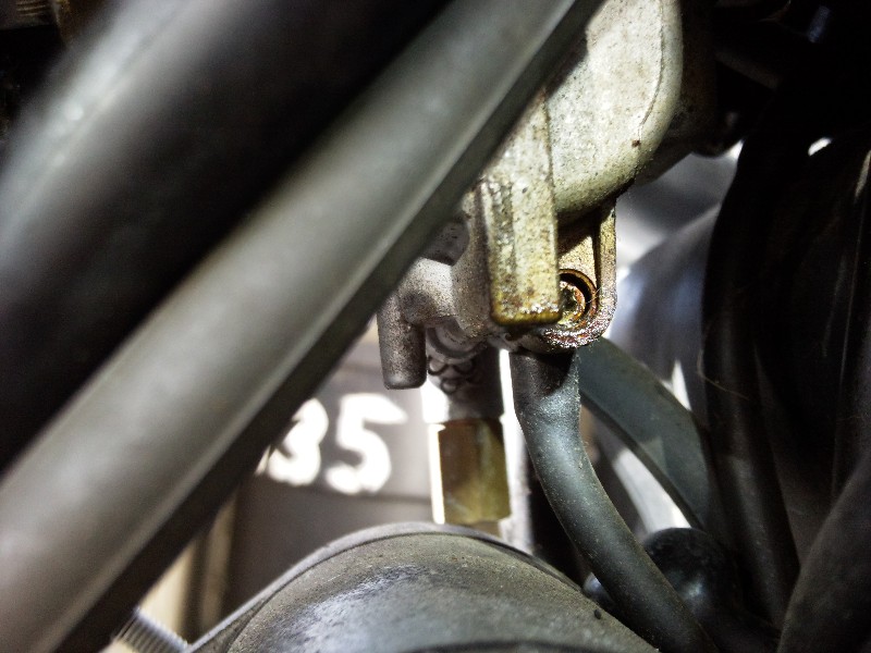

Where exactly is the drain screw on the carb? There is a small screw at bottom left of the carb with a small rubber hose nearby. Is this it?
Is this the drain screw for the skorpion carb?

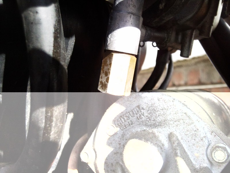

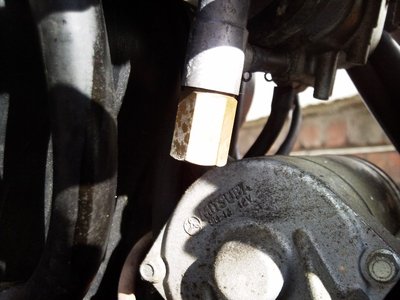

What is this HEX bolt for on the right hand side of the carb?

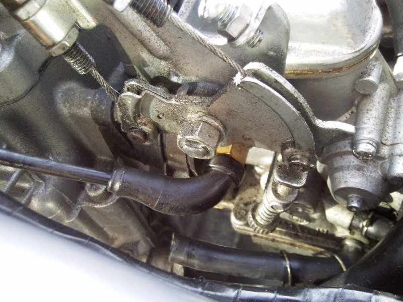

While I'm here are there any tips on removing the cables from the carb?
Is there an easy way to remove these?

#1 Yes that is the drain screw
#2 Hex bolt is for access to main jet in the CV half of the carb, you will understand when it is in your hand.
#3 Just release the tensioners on the carb and unhook the cables, choke plunger is removed by the brass hex on the side.
