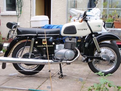

Hello everyone! This is my first post as I came across this site today whilst looking for some tips about my ill ES250.
I got the bike last month and have been well chuffed with it until last Friday when it stopped working.
Here's a piccy of it -
Here's what happened. I was riding along when it started to miss , almost like it was running out of fuel - then pick up again. It just about got me where I was going but then wouldn't start afterwards.
When I got back home (recovery truck ride!) I cleaned out the choke mechanism and it started up but wouldn't rev properly then died and would not start again.
I have cleaned out the carb, reset the flost height etc and it made no difference - the only thing I can get out of it is a backfire and the occasional brief burst of life.
Right then - time to look at the ignition system. It has a twin plug head fitted and also has Boyer Brandsen points assist ignition. The points were sticking slightly so Ive cleaned them up and regapped and the timing hasn't moved. I checeked the voltage on the battery and that was 6.2 V. I've heard that Boyers are quite sensitive to voltage so I charged it up for a couple of hours to 6.6V (static) and after a couple of kicks it fired and ran for a while but would not start again after that.
I'm thinking that ignition problems seem the most likely now - has anyone else had problems with these Boyer units? Or any other ideas of stupid things I may have missed. Oh I also put new plugs and that made no difference either.
