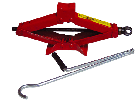

A old car-lift like picture help a lot; down the engine is unconfortable, it is a bit
heavy.
