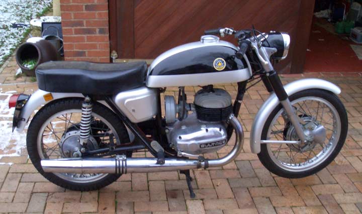

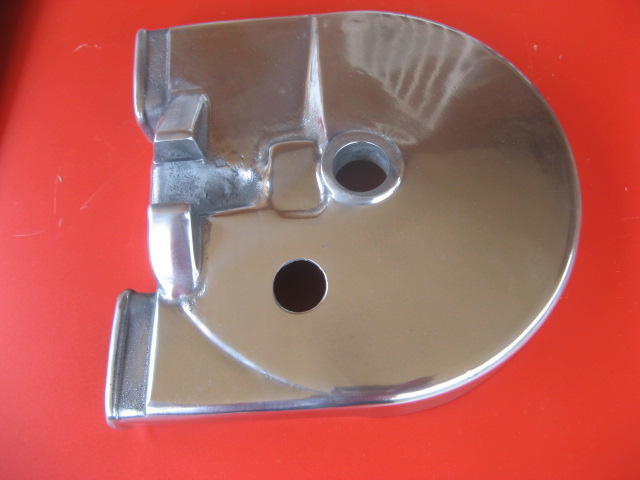

I was thinking open a oil hole my rear sprocket guard-same model in your SilverStar (bakelite)- when I saw
a Bultaco Metralla guard.
Observe the correct oil hole position. centrifugal force make the work.
Problem, I have not good accessibility to rear sprocket guard because same side exhaust and a bag.
No problem for Bultaco: right side exhaust left side chain.
Saludos/Regards.

Re: Plastic Chain Guard Necessary?
Postby comanche91 » Thu Oct 22, 2009 6:41 pm
Thanks manumensa, I'm trying to run down a set now. I didn't even know they were rubber and functioned as a chain guide because they were missing on my Silver Star. I don't know how long they have been missing, but the chain has chewed up the rear sprocket guard a little bit. That Metralla is a beautiful Bultaco. Will that rear sprocket guard in your picture fit a Silver Star?
Postby manumensa » Thu Oct 22, 2009 7:35 pm
Don, unfortunately not compatible size and
you need connect speedometer drive cable in
a MZ sprocket guard.
Price Bultaco aluminium sprocket guard also hight: 190€!!
