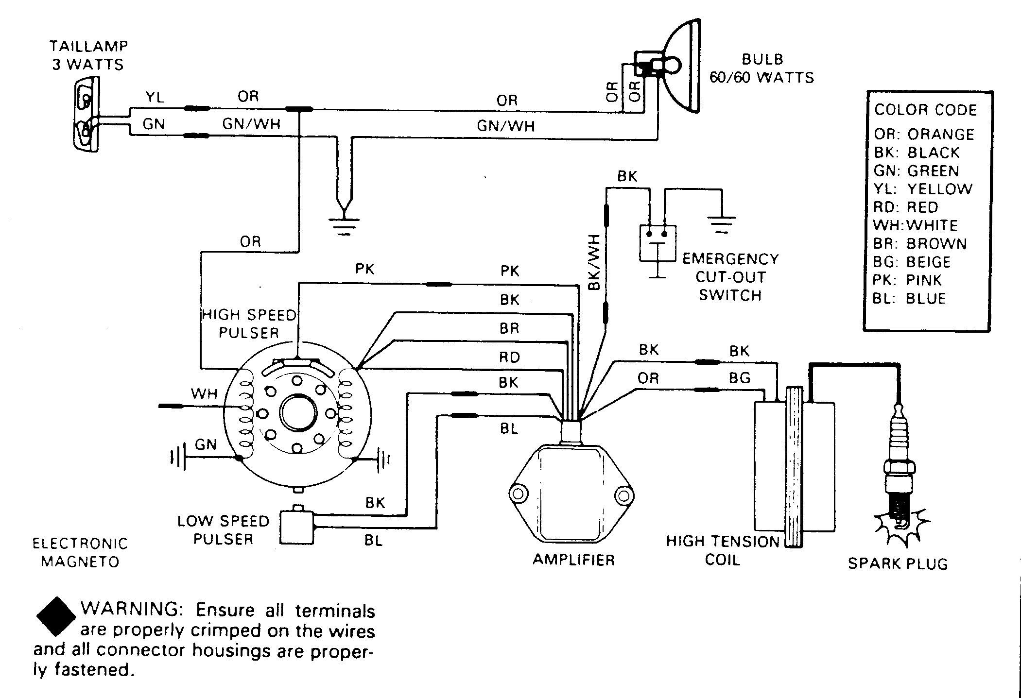

here is only drawing i have
the picture shows a potted device i do not know for sure but think it is used to ground or kill the ingition
found drawing its a interference filter 22 on drawing
as a wire of it goes in to loom to front
also the black white wire is grounded in the simple system on race motors to kill
i have not had any electrical problems with mine so have not did a lot of tracing

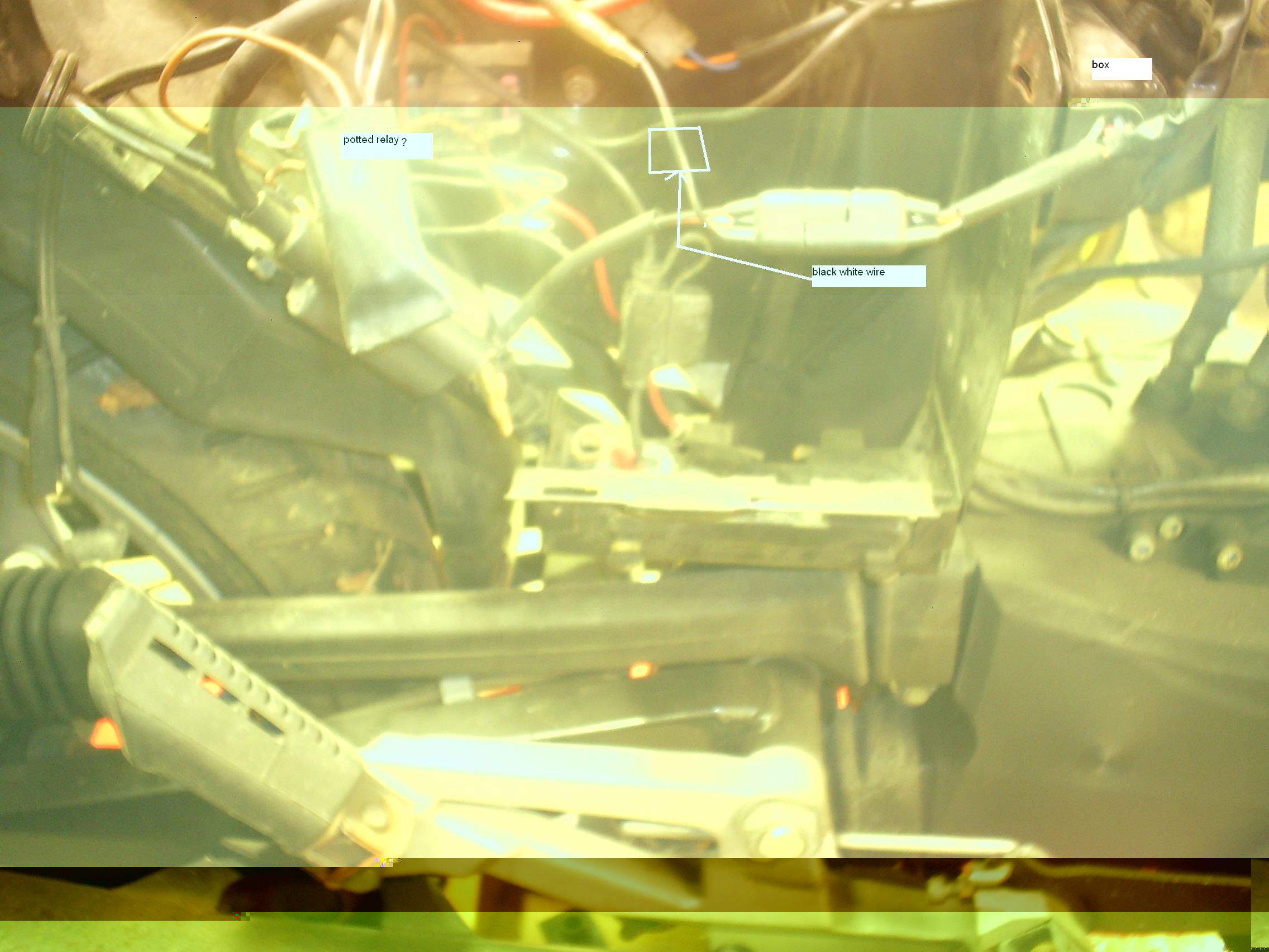

Postby 95SaxonTour » Wed Aug 12, 2009 11:54 pm
Yeah, what is that potted relay thing? Mine has that too.
I'm thinking that that may be the issue here with my bike
because I'm not finding any of the tell tale signs of PO
monkey business. No obvious wires dangling or hunks of
electric tape or wire nuts present. I did suspect the potted
relay contraption as a PO cob job till I saw the pic of yours.
I dont know how this relay works. Im thinking that when
the bike is grounded out (shut off) that the relay kicks in
and grounds it out directly to the frame. It does have a
lead that grounds out at the coil. One lead (black/white) is hooked
to the ignition box (black/white) and the other goes off to the
loom to the front (brown/white). Bear in mind, I can't find this
relay anywhere on the factory wiring schematic that is in the
owners manual. Of course, the manual also says I have a Dellorto
carb.
