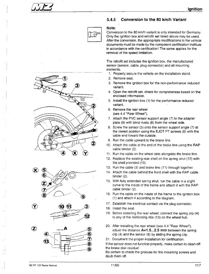

Postby djsbriscoe » Fri May 22, 2009 4:49 am
Hi,
Have you considered that it might have a restricted CDI box fitted as described in this page from the workshop manual
[img]
[/img]
If so, the cdi box would be listed in the parts book and on Grahams website so that you can confirm if it is or isn't the standard box.
David.

Postby robert mack » Fri May 22, 2009 1:50 pm
hi mate
its not a restricted one im afraid. i phoned the scottish mz dealer and spoke to him, totally stripped the carb and i mean totally lol so im off to put it back together and see if that helps.
