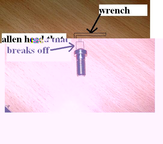

check the screws that hold the key switch in to fork
its a break off bolt the head comes off when its installed
and the loctite did not hold it in
get one same thread size with an Allen head and lock tite it in
and see if the other one is loose
edit note an other post shows a
break-bolt for the saddle-lock /seat lock ??
check them both

Postby MIAMIMZ660 » Sat Jan 31, 2009 9:52 pm
LOOKS TO BE A BOLT THAT HOLDS THE IGNITION ON
SAFETY NON TAMPER BREAK OFF BOLT INSTALLED AT THE FACTORY.
HAVE TO BE DRILLED OR SLOTTED TO GET OUT AND USUALY HAS RED LOCTITE
