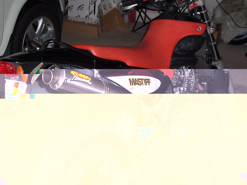

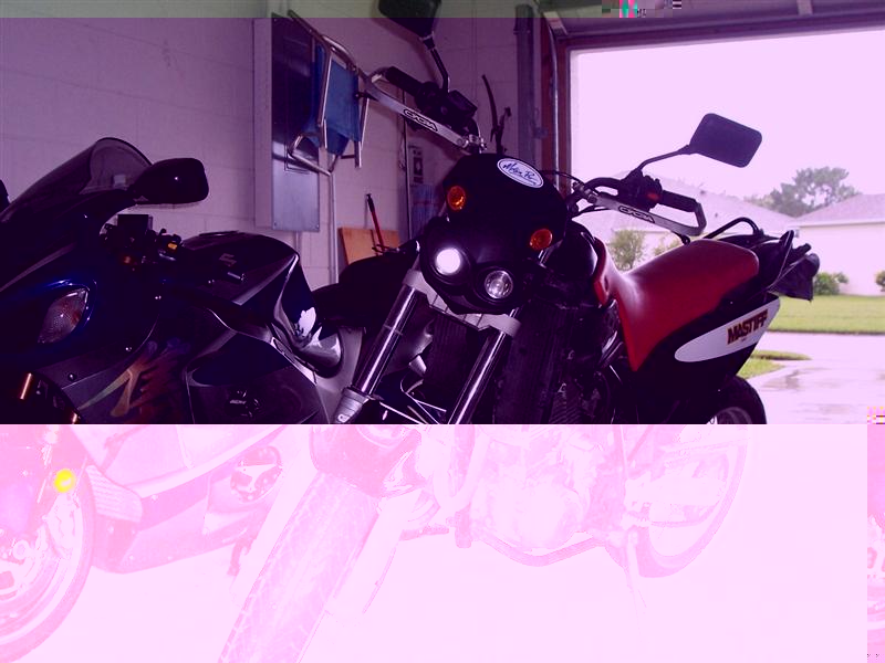

98 Mastiff Hot Cam, 11to1 piston, 40 over, jetted, pins 3 down, primary set @ 5 out. Anyone! Ever had a prob with the Idle hanging up unless you blip the throttle a few times or advance the throttle butterfly on the parasite carb by fingers? Runs strong and smoothly otherwise, starts rite up. I tried adjusting everything I can think of! Even took the cover off both carbs and checked the diaphragm on the vacuum operated (parasite) carb. The 7mm adj for parasite kick in is ok, no lag when rippin. Man I hate to go into these there is always a kit involved. This has plagued me for a few months now! now I got time with this storm hangin around to fix it. Any info or suggestions will be greatly appreciated for sure.
