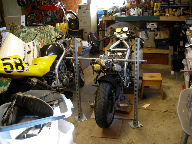

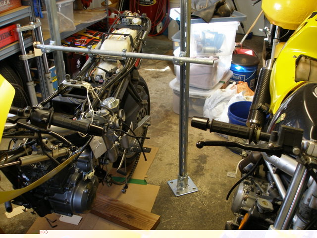

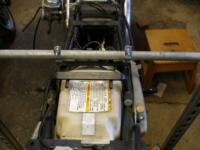

Got the engine out with a homemade holder consisting of some rigid conduit attached to minerallacs where the seat cowl bolts screw in. Conduit is now at right angle to front/ back layout of the bike. Made vertical stands, one for each side of bike, out of unistrut with bracket to hold conduit/pipe. With bike on Pitbull stand to get rear end off of the ground I adjusted the brackets up to the pipes, tightened the brackets, pulled the stand out and was able to get the swingarm elevated with no weight on it. I was able to get the motor out myself with judicious use of ropes, small bottle jack and some skinned knuckles. Took the motor over to the former owner of a bike shop here in the Detroit area and he was able to re-do the top end for me. Was able to get the motor back in today by myself using the same stoneage methods. Once I figure out to post photos I'll put them up.

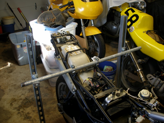

Pic four shows the cross member that I used to wrap the rope around that I had tied through the top motor mount bracket. I raised it until I could pivot the rear of the motor to where I could get one of the rear mounting bolts in and just carefully continued to jostle the motor until I had all the bolts in. Pics 1 thru 3 shows the "stand" I made to get the rear unloaded to accomodate the swingarm/rear mount bolt. Hope this helps.
