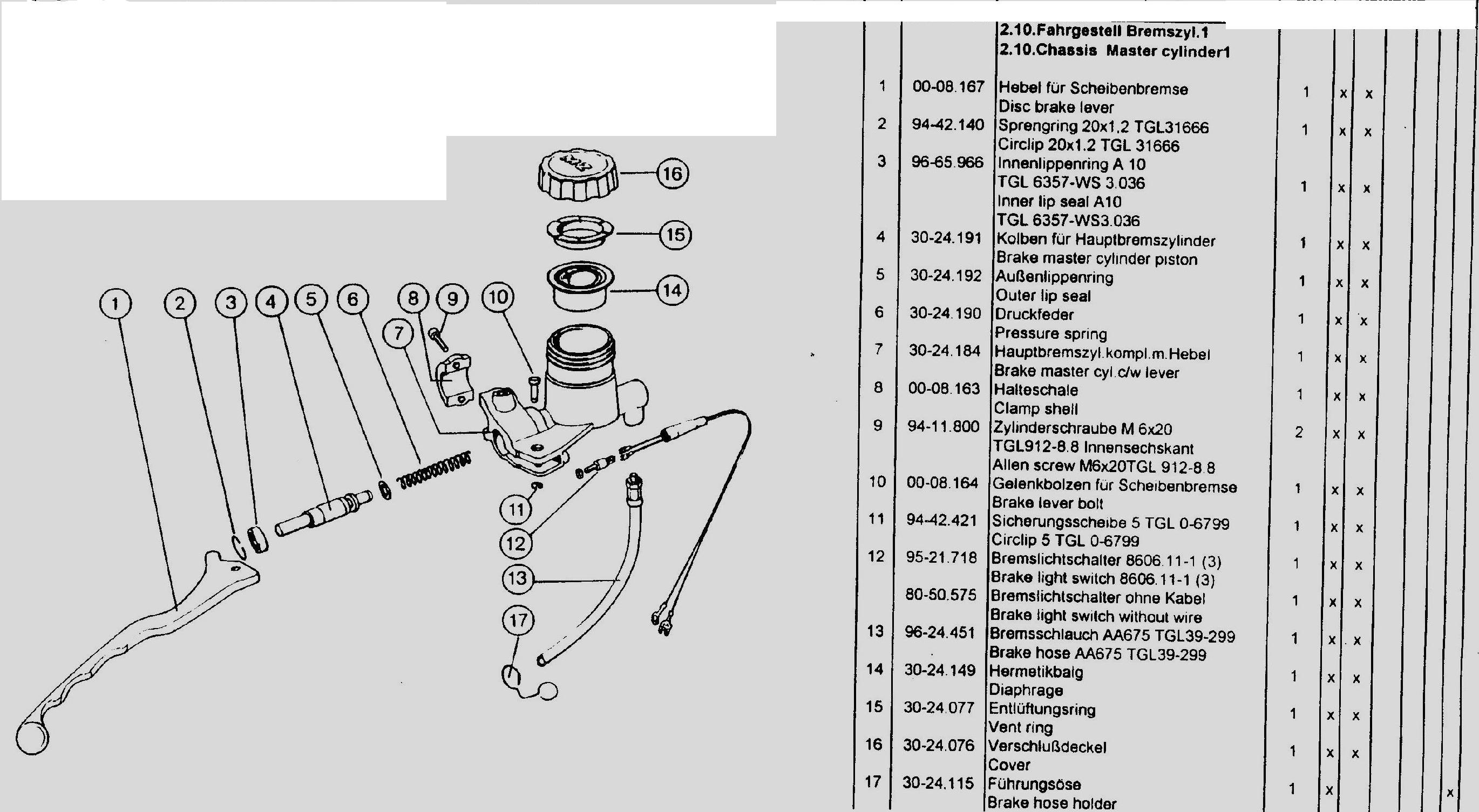

Postby DAVID THOMPSON » Fri Sep 21, 2007 10:40 pm
the parts up on the handle let fluid bleed back after you release brake
sounds like problem is in master cylinder
i will look at my parts book and see if overhaul kit is listed
does yours have a square top or screw off round top where fluid is poured in to reservoir
on there round top cyl there is a spring in side
ar dave
ps check if hand lever has full return travel when released or pressure will not release
items 2 to 6 on page
if this is not your master cyl i can post other one
or if you have parts book its on page32
book 31.jpg (455.32 KiB) Viewed 3369 times
Postby phlat65 » Sat Sep 22, 2007 10:25 am
yeah, if you crack the line or bleeder at the caliper and the brake releases, then you have a problem in the master. if the brake is still stuck, then caliper. did you make any recent adjustments or repairs?

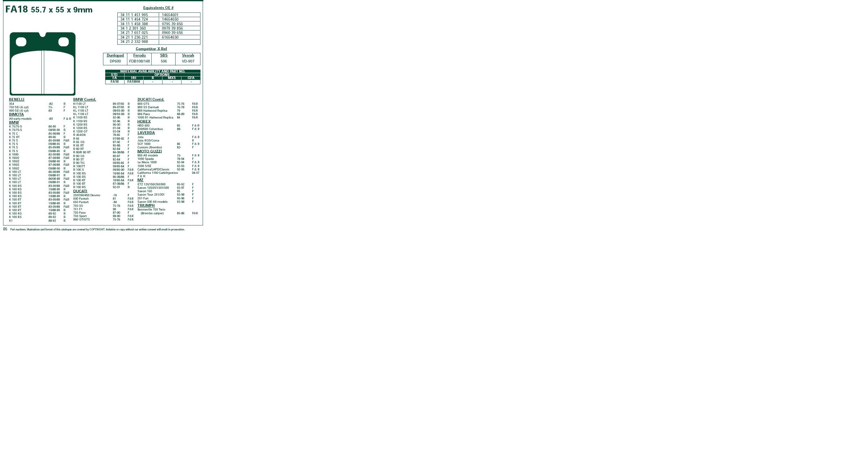

fa18
Postby DAVID THOMPSON » Mon Oct 01, 2007 9:36 pm
ebc fa18
some bmw models 1981 on
parts unlimited # = 1721 0259 = sbs 506hf r
came out bigger than i wanted but here it is for all to see
what fa18 fits
ar dave
the ebc listing
