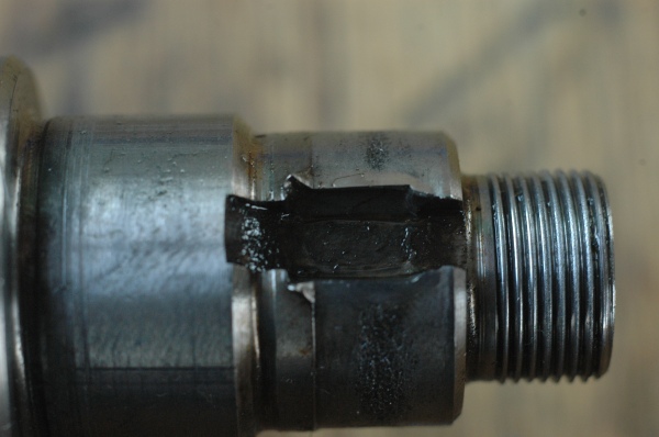

Less often but also possible is damage to the keyway of the counterbalancer which in the end can cause the same BIG trouble.
If you cannot find teh cause with the first two possibilities, remove the side cover and check the primary gear train. Otherwise it could get very expensive indeed!
damages keyway in a counterblanacer of an xtz engine - not one of mine!

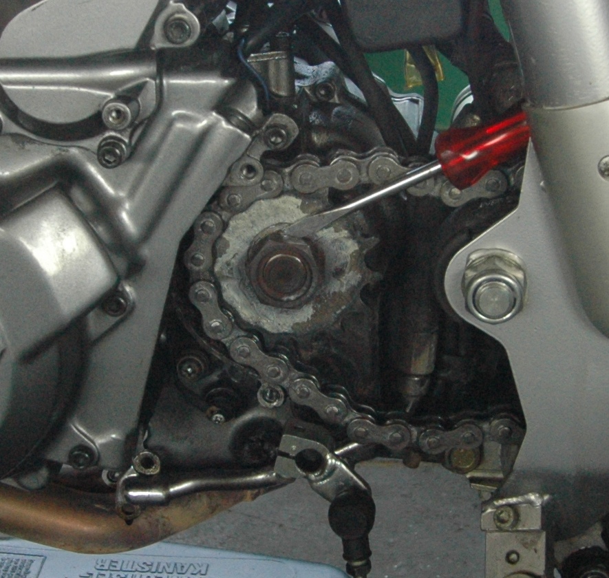

- the cog: I have seen the locknut put on backwards by a dealership shop. This done, the nut is tight but the gog is not and the splines will eventually shear off.
-serious: the Woodruff key in the crankshaft for the primary gear and the countershaft drive gear may be making the noise. This happens unfortunately far more often than Yamaha is willing to admit. When it gets play, this will increase until the the key is sheared off, at which moment the counterbalancer and crank will meet for the first and the last time...
If you cannot find the cause with the first three possibilities, remove the side cover and check the primary gear train. Otherwise it could get very expensive indeed!
nut reversed. note also the missing lockwasher. was previously at the dealer's.
damaged keyway in a counterbalancer of an xtz engine - not one of mine!

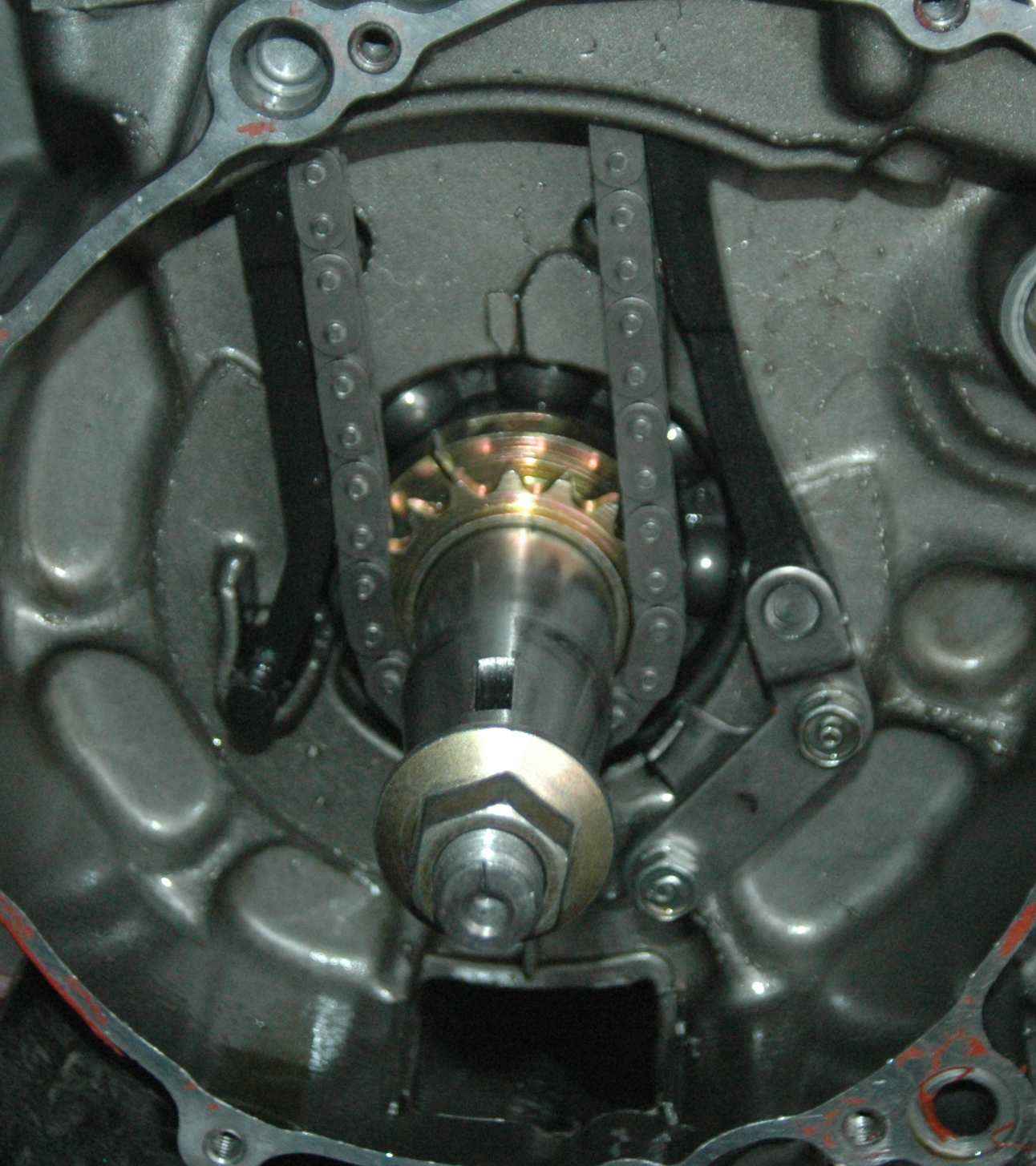

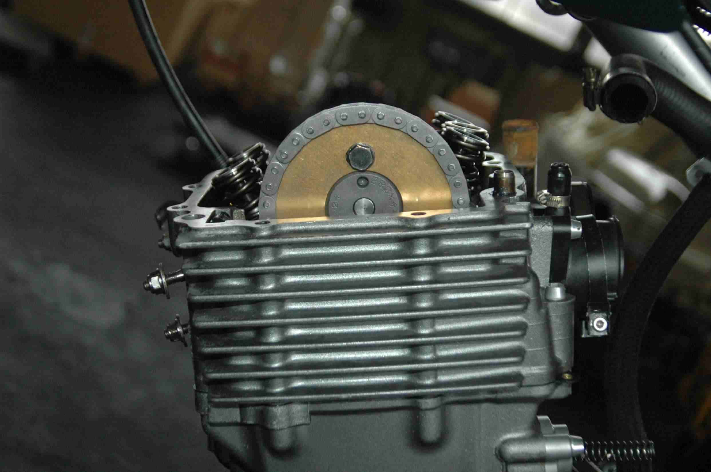

roller chain kit from Slipstream with crank cog. The mark I made with a cold chisel on the end of the crank show where TDC is from the outside thru the centerhole of the side cover. This is the racer engine which has no side cover. The crank is a one-off
roller chain with top cog. You can also see that there is no decompression mechanism and in the background the Kibblewhite springs with titanium retainers. By the positon of the retainers, one can see that the springs are quite a bit longer.

Postby Bill Jurgenson » Tue Jun 26, 2007 12:12 am
Bill, is that damaged keyway a stock engine or a modified higher horsepower engine ?
from a stock SZR engine used in a custom built sidecar bike.
