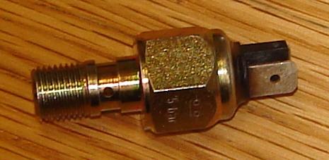

Could any one help please with the fitting of this switch as I can unscrew it but can not get it off the brake line.
Please see the picutre.
MZ Rear Brake Switch.JPG (19.71 KiB) Viewed 2715 times
Thanks For Your Help

the brass washer may be squashed to much and binding it up
