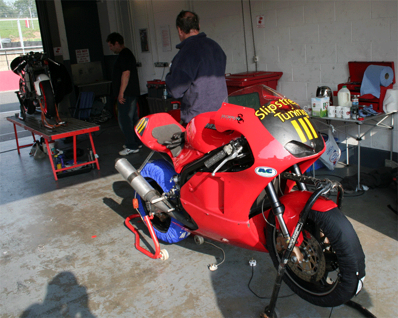

Postby Wonky » Thu Nov 23, 2006 12:06 pm
The 2 into 2 systems we use on ALL our race-bikes, "Cookie" exhaust systems, they work fantastically and Cookie is a talented guy with years of experience. You can have Aluminium or Titanium casings on the cans. He has made exhausts for tons of MZ, SZR's and so on. We are actually based in Sevenoaks buddy. Bromley is just up the road from me. I would need to know if you are running the side-stand,etc so Cookie could make your system for you. He actually likes to take the bike away and custom fit the sytem to fit your bike, this is a great way of ensuring an absolutely snug fit. I can arrange it all for you if your in need of a system. The bike pictured above boasts Cookies exhausts, that was on a test day at Brands Hatch a few weeks ago, Whysub was there too. Any help i can give you is here buddy, just ask. We have started to list MZ/XT parts on our online store now, custom parts will be there soon too.
