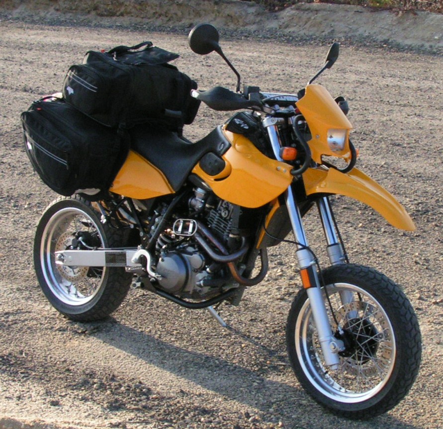

After a mad blast riding home yesterday I noticed a strong fuel smell after I parked the beast in the shed. This morning the smell was still strong but I backed it out and tried to start it up. No go...just fuel spilling out the overflow tube from the carbs. I turned the fuel valve off and let it sit. Two people I asked said it's probably stuck floats. Can anyone suggest a remedy?

btw: Acerbis hand guards, scuffed up good with a Scotchbrite pad. Only now my mirrors vibrate at 55mph+ whereas they were clear before. I think the additional brace points on the bars exagerates in the mirrors. Hey...how do you like the 125SM? I think I may get 1 for my wife.

I rode to the bike shop...picked out Renthal bars, grips and the Acerbis guards then did all the work in the parking lot within about 2hrs. I had to cut 3/4" off the levers but the guards were easy. The freakin grips took almost an hour to slide on. Hardest part about the guards was trying to get them adjusted evenly... no big deal.
1. They are really tough. I went down pretty good once in sugar sand on the throttle side and they kept the bars straight and throttle clean...probably saved the front turn signal and side panel too. Broke the front fender though. $100 from MZ. :roll:
2. Noticeable wind protection on hands, especially in winter.
3. They do look good...and that's what counts right!

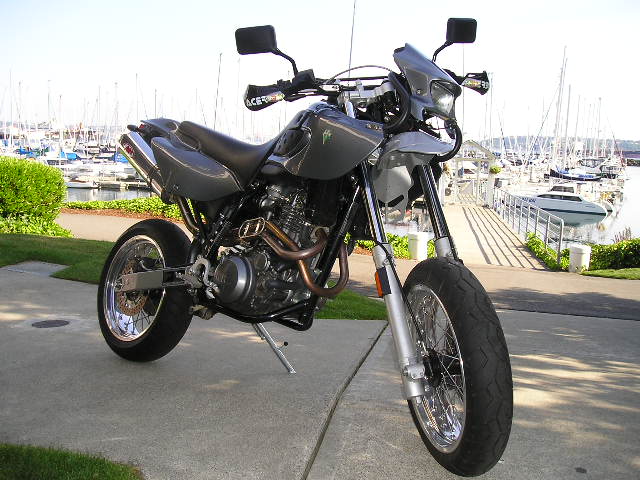

Islander just what (8) said on the bars and acerbis stuff.... easy, lining them up is a pain though.... by the way Acerbis makes a universal SM front fender for $ 29.00 although it doesn't protect as well as the stocker but cheaper and better lookin..... Phlat and I put lock hart phillips blinkers on our hand guards... I put higher watt bulbs in and painted them orange, changed the 3 amp fuse to 5 amp fuse and now you can see me a mile away.....

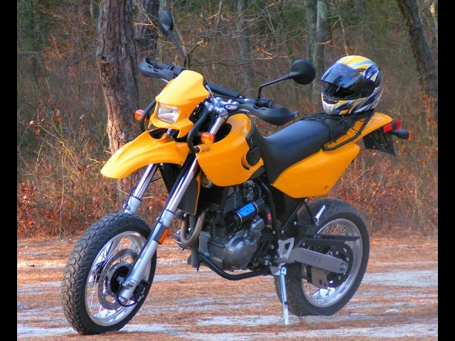

Thanks for the information. By the way, (8), that is a bit of false advertising that could get you into some trouble. I am talking about the NOS sticker on the black can. Does make it look useful though.
