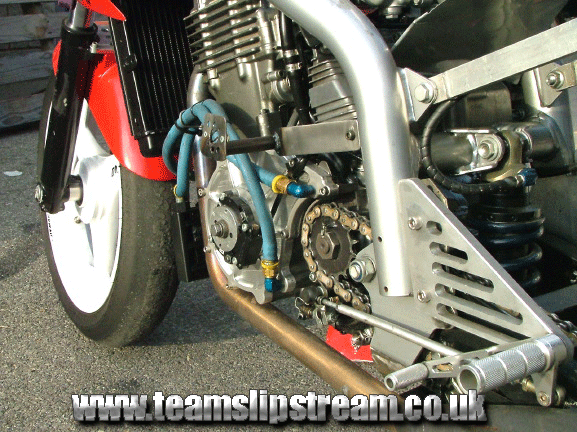

Eric Mersers MZ Skorpion - (Full Race Tuned)XT660 Engine modified by Slipstream Tuning!

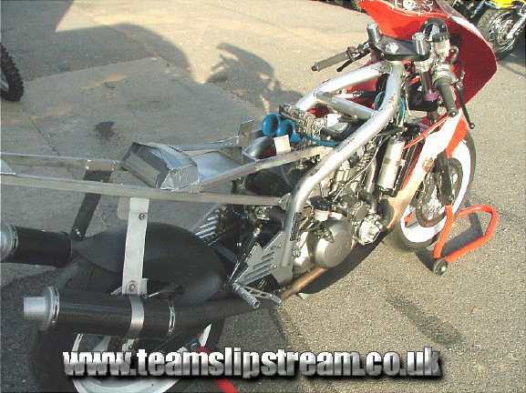

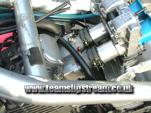

Postby Wonky » Mon Oct 23, 2006 2:45 pm
And some more... :wink:

Postby tuny » Tue Oct 24, 2006 9:34 am
Wonky wrote:Eric Mersers MZ Skorpion - (Full Race Tuned)XT660 Engine modified by Slipstream Tuning!
can you explain al little here? and have some more pics? this looks hot without the flywheel and starter, you need to jump sptart it now? how easy is that??

Postby basser23 » Tue Oct 24, 2006 9:52 am
Tuny, he probably uses a roller starter..it is a set of rollers that are attached to a car or truck wheel..sort of like a dyno roller. The bike is
placed on the rollers which spin the rear wheel...not practical for the
street obviously...

Postby Wonky » Tue Oct 24, 2006 10:36 am
The bike is for RACE ONLY and not suitable for street as stated above, you would need to use a roller starter for the bike!
