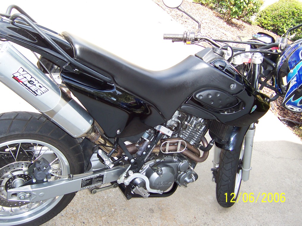

i love my mz black panther but i think i need to replace the clutch. anyone know where i can take it in sacramento?
love it
my mz.jpg (265.82 KiB) Viewed 7244 times

No help on the clutch, but did you just get the bike? It looks quite clean.

thanks i like it alot and yes i just got it about a month ago its an 03 got it for 4000 :D
