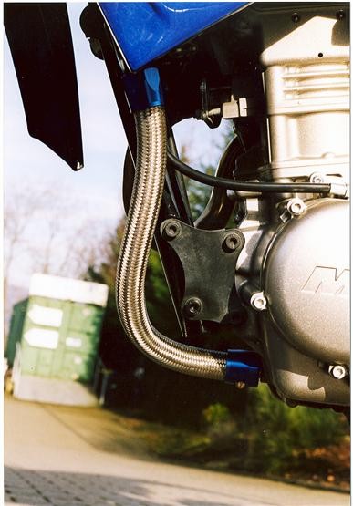

For my MZ, I replaced mine using CPE hose. If the bends aren't too crazy, then this is a viable alternative. Note that the 125SM has two right-angle bends...
MZ 125SM front rad hose.jpg (27.97 KiB) Viewed 4463 times
Relax. You'll live longer.

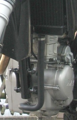

Postby Drew » Mon Jun 12, 2006 3:24 pm
This is what I replaced it with (not my bike, but it looks the same)
MZ 125SM CPE.jpg (54.08 KiB) Viewed 4461 times

Postby keithcross » Mon Jun 12, 2006 5:46 pm
Hey that looks a lot better and stronger. The hose looks real vunerable where it is and I can see it getting damaged if the bike is used off road.

Postby Drew » Tue Jun 13, 2006 1:07 pm
keithcross wrote:Hey that looks a lot better and stronger. The hose looks real vunerable where it is and I can see it getting damaged if the bike is used off road.
Keith
Thank you! The stock hose is braided, but the new one is a bit thicker and much nicer. The only drawback is that the connector from the rad is 1/8" larger in diameter than the connector into the engine. It just took a little more "oomph" to get the hose on the rad (not so much that it killed the radiator, though!).
