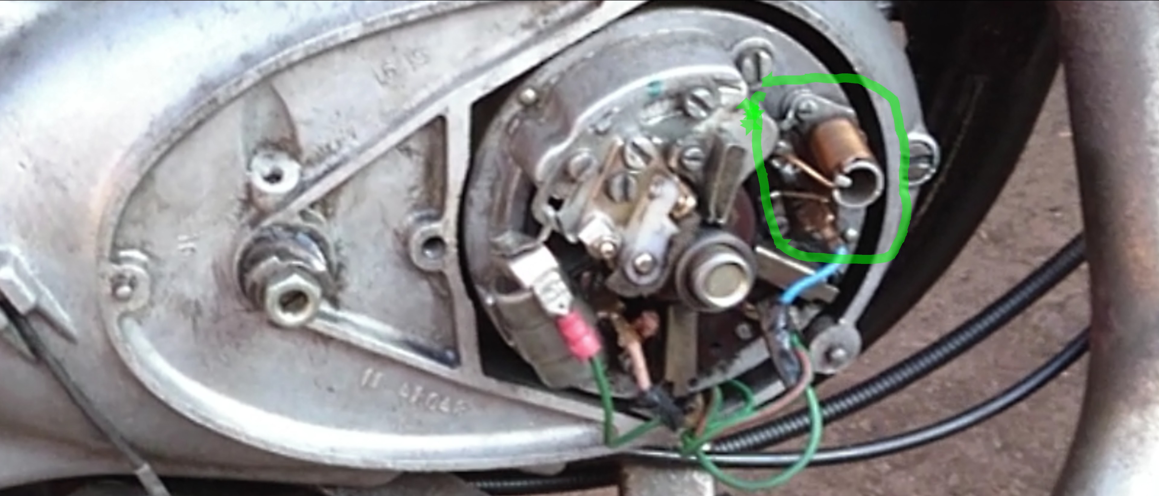

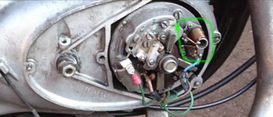

Have you inspected this part (below in green) as it has a say so in starting, charging, misfiring. But like a duff condenser the contract breakers (and this part) will be burnt, charred or melted. Your coil should've been hot enough to fry a egg or flesh.
A multimeter is a necessary extra when dealing with any electrical fault..

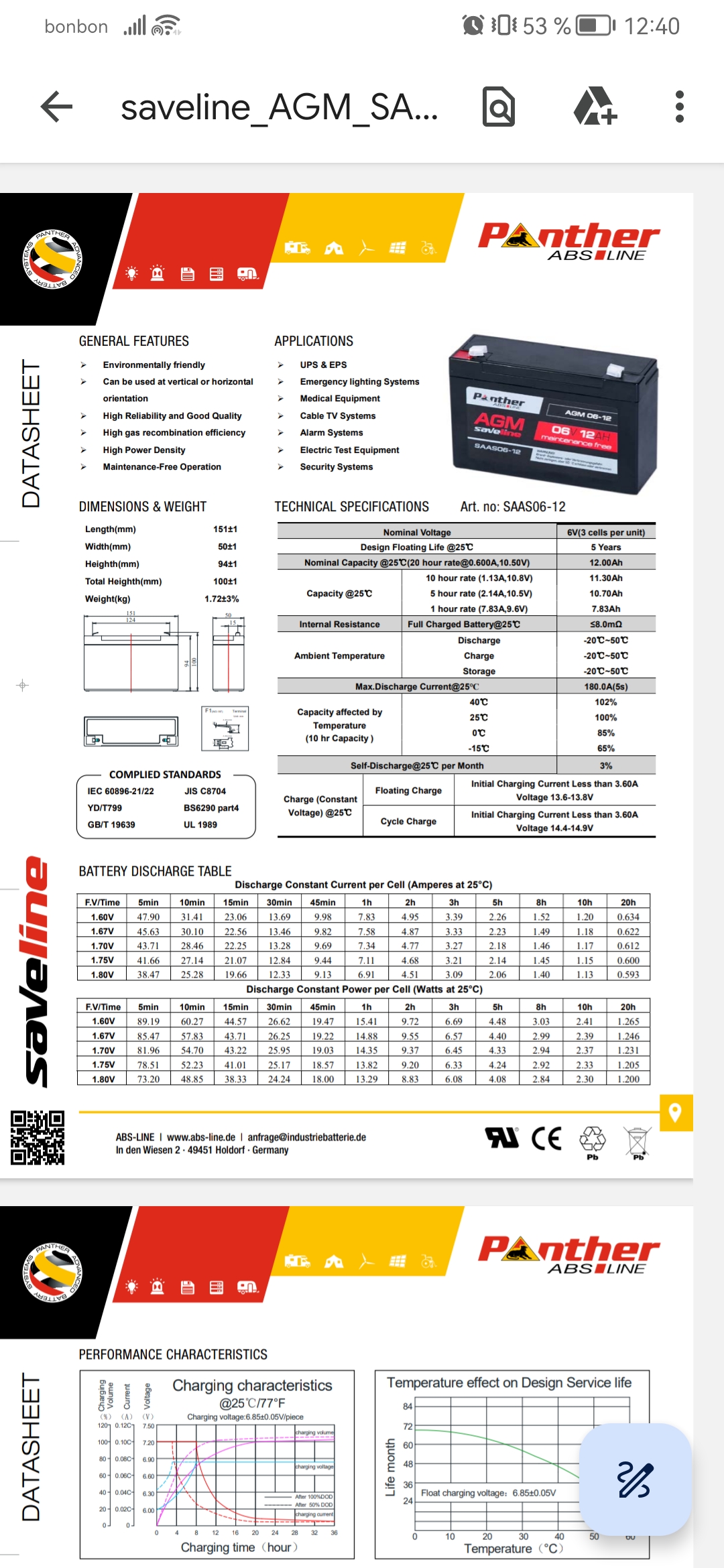

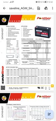

Is good if i put 6v - 12ah AGM Panther battery for MZ? Now I currently have a classic acid battery of 6v 11 Ah (6n11a model)

I don't know. They are not really designed for motorbikes, but I think some people have used similar ones successfully. I've only used lead acid batteries like the one you have fitted, which is the correct one for the bike.
