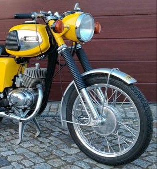

Any Mz Ts 125/150 made after 1976 right up to the last ones made (or sold as 1987 E regs) were all the later engines. The give away is the pre 1976 models had chrome plated steel fork bottoms on the front end and the fork sliders were slightly smaller
Later models had alloy bottoms painted black crackle.. the frames were much the same though. Later front ends fit on earlier models. Most changes were model specific.

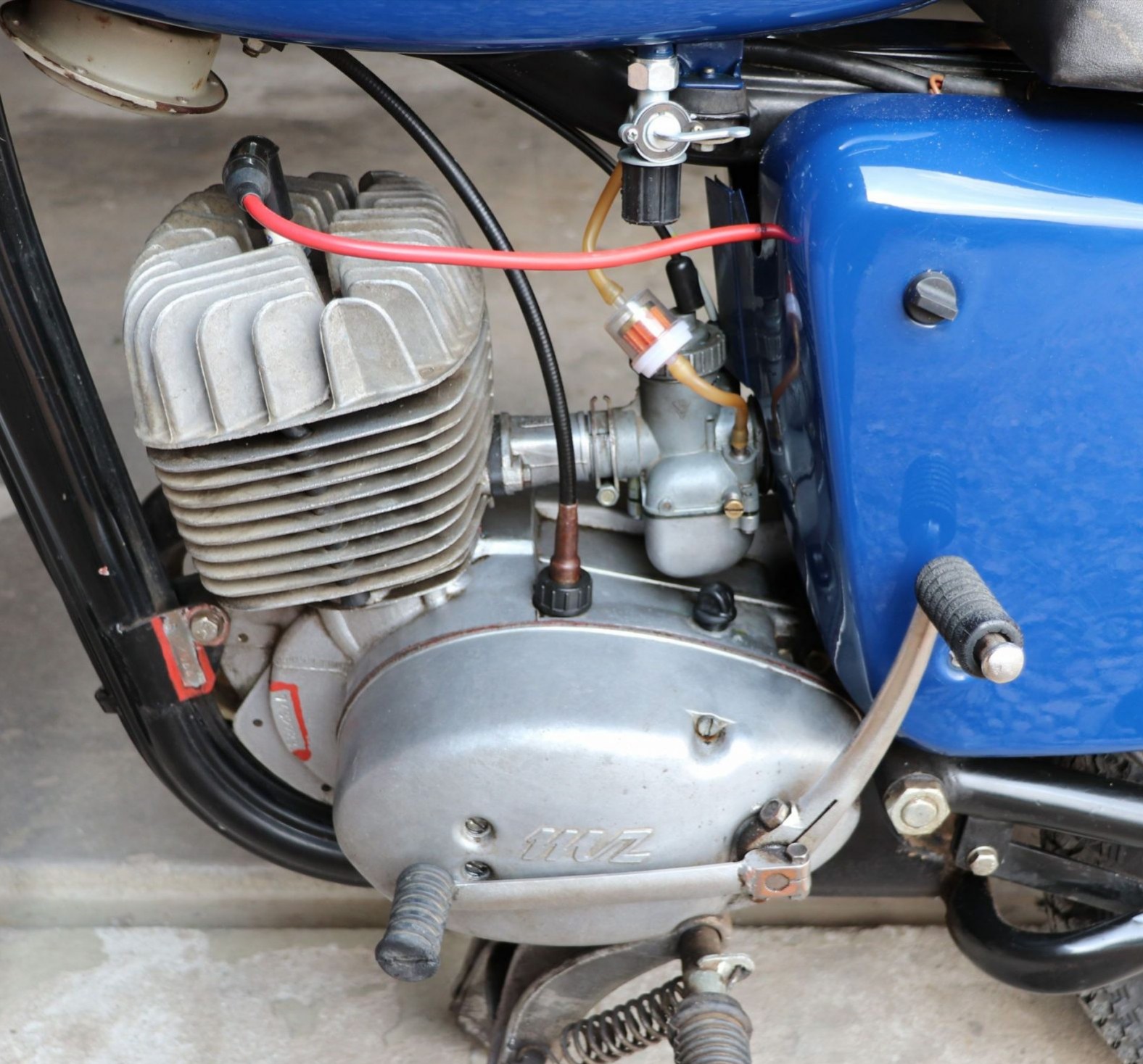

Can anyone help with an engine number that would signify the change to the later engine.
I have an ES150 registered in UK in June 1976, engine # 6542969 - how do I know if I have the later engine ?

Take a photo of the engines head, then the bottom. Then put it into here or google lens/.images.
And see what comes back. :lol:
earlier model
later model, but they look the same externally
