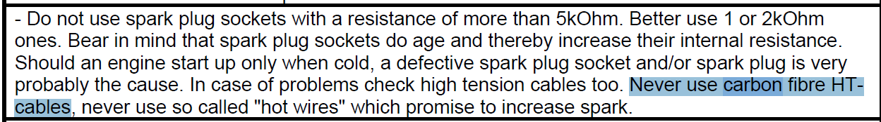

Postby Chris W » Tue Oct 11, 2022 12:42 pm
Congratulations BM on solving the issue. One related comment re carbon HT leads. The instructions for the Vape electronic ignition strongly state not to use carbon HT leads with their ignition - implication being it adds too much resistance (so weaker spark I guess).
