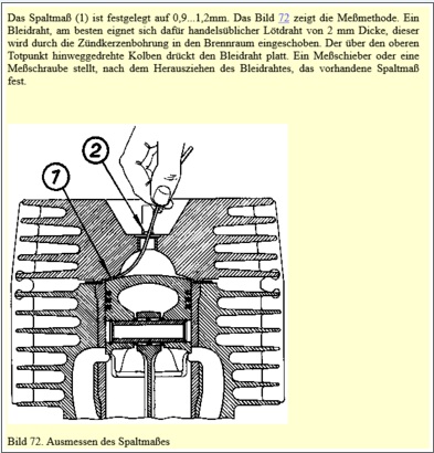

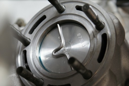

On your question to re-bore or not, you have to measure the barrel. If you do not have the tool for measuring such a bore ID accurately, you have to go to a workshop that has.
Head gaskets come in tens of mm, not hundreds. Do as Kruh said, for reference the solder method:
Bild 72. Ausmessen des Spaltmaßes = squish
See the strip of solder (I use rosin cored) is placed at the left or right side, not front or rear, which should be even easier with your decentralised plug hole.
Some people actually take the head off & wedge a piece of solder in the top of the barrel, to prevent loading only 1 side:
Then fit the head & rotate the crankshaft (at the flywheel, or kick it) to take the piston through TDC. Subsequently you can measure the squish size by the thickness of the squashed solder tip.
For the ETZ I use the top method, which is from the ETZ manual.
If you fit the same gasket size as before, tighten the head & measure, with a bit of luck you're done.
