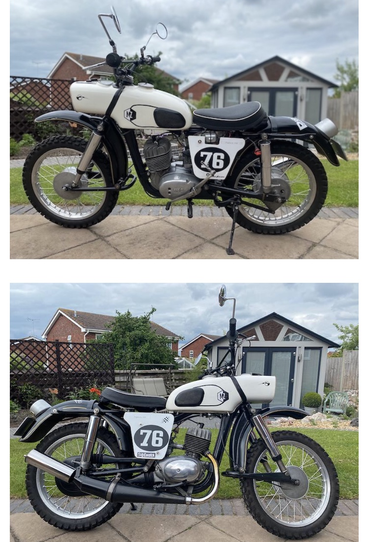

Postby ScotBob » Mon Dec 06, 2021 12:37 pm
Some pics:

Postby breakwellmz » Tue Dec 07, 2021 6:09 am
ScotBob wrote:Some pics:
Lovely looking bike it has a very 60s ISDT look to it, such a shame it has suddenly (and strangely) become problematic.
