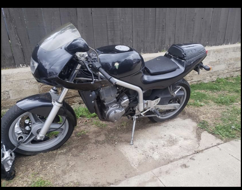

I just bought a 1996 mz scorpion 660 sport a couple of weeks ago and i was out riding today and the rear sprocket came off the hub, look like all the bolts just snapped off. This is my first bike and i don’t know anything about bikes. But I’m learning, looks like i need a new hub. Anyone possibly know where i can get one ASAP or know of any other bikes that has the same I’d be able to use on the bike, I’m currently living in south Cali and closest people i know is 1200 miles from me the bike is my only transportation rn so need to get this fixed ASAP.

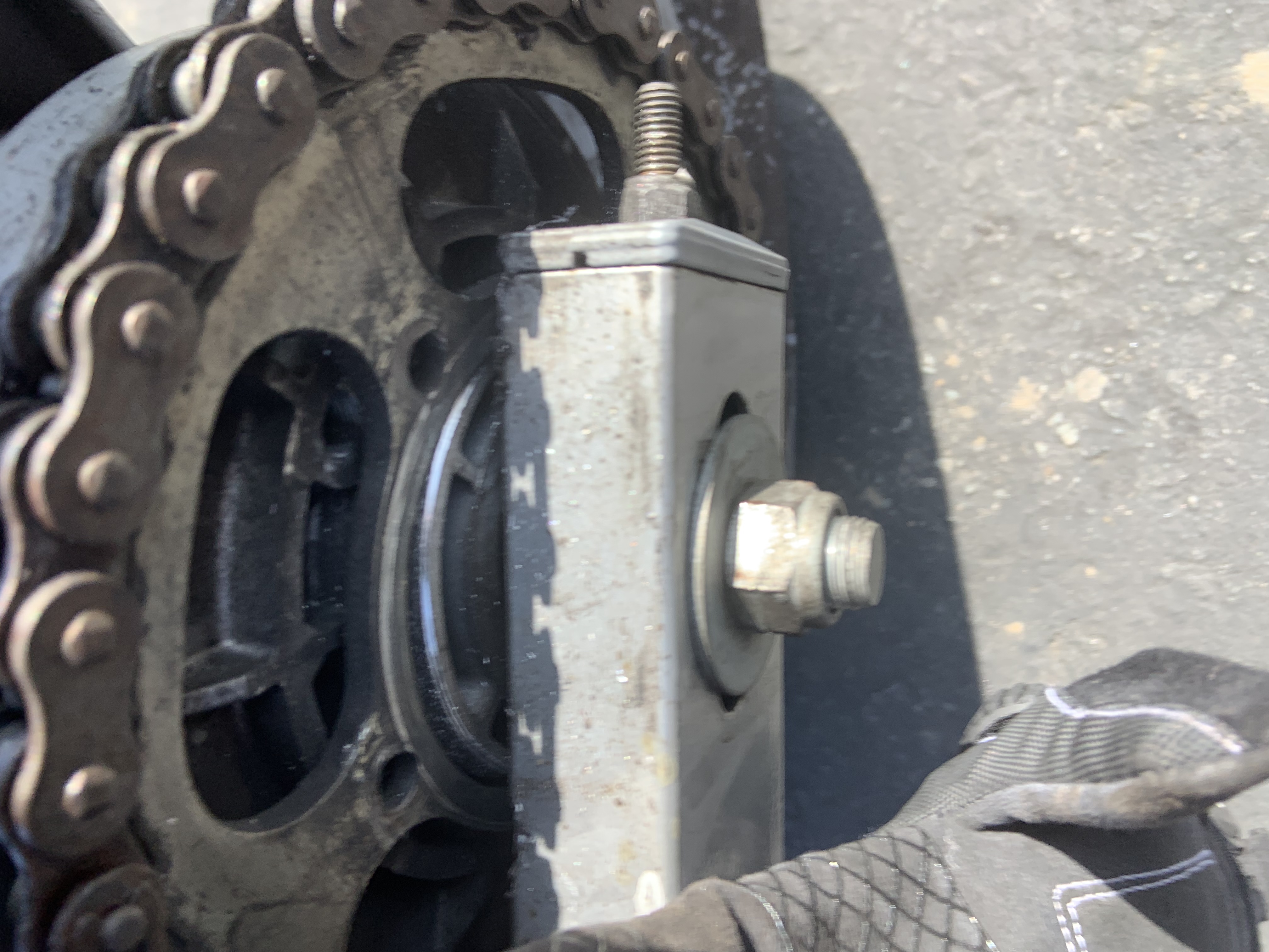

One bolt snapped off for sure. But all the bolts came off somehow, the bikes parked at a Costco parking lot rn but I’m gonna try to get some more bolts for it for now and see if that will at least let me get it to where i need to get to until i can find a new part I’m not sure what caused it, maybe the person i got it from hed the chain to tight. But rode perfectly until then it’s a great running bike just the fairings are tore to hell and the wind screens missing but hopefully I’ll be able to get it looking good again eventually. Thanks for the input guys I’ll post more pics of the issue here in a few I’m getting ready to head over now

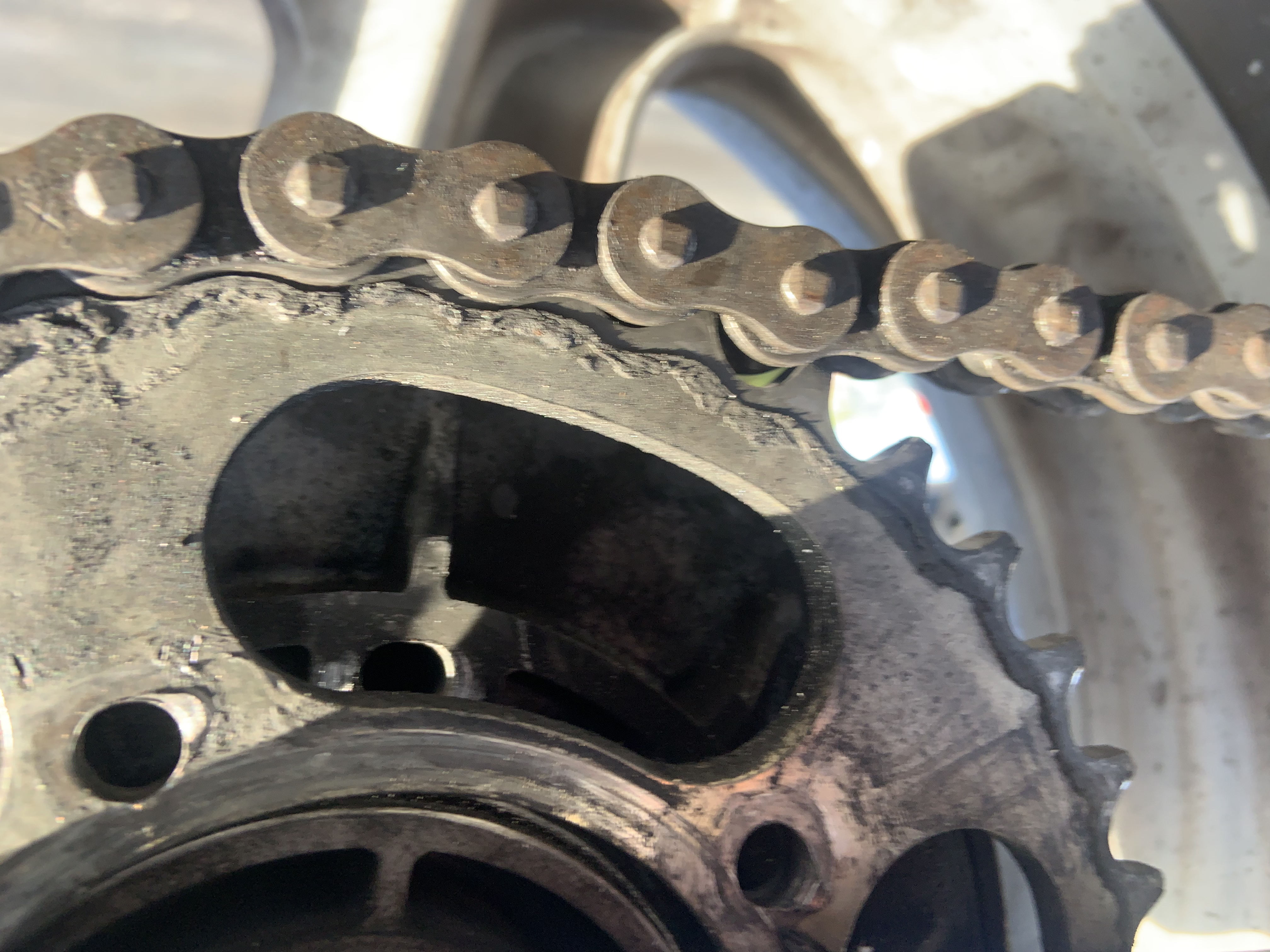

Here’s another pic

get some 8mm bolts in there (these are some "captive" nuts in the hub that they thread into). you can see that the sprocket holes are oblong so the bolts been loose for some time.
Also at a minimum get some lube on that chain or ideally replace the chain and both sprocket . Its long overdue - that sprocket is very worn and chain doesn't have much life left.

those captive nuts may not be totally captive when the hub is out of the bike
and if so may need replaced also if its been loose fore a while
and the bearings need checked and some repacking or replacements
looks rode hard and put away very wet and abused

So the new nuts and bolts worked thankfully, ya it’s a work in progress i just got it a couple weeks ago. Paid only $900 and an iPad for it, only needs small things fixed mechanically wise runs pretty good starts every time,but cosmetics is a different story haha. Thanks for all the help and advise, also I’m going to have someone check the back wheel for me tomorrow to make sure i put it on straight and chains not too tight or loose

Come home, take the wheel out check the bearings, replace the nuts. Yes use thread lock, maybe in combination with new locking/non-slipping nuts (which I now learn are called 'captive'). High tensile bolts? Yes, as anyone can see (see links to miraculis.de elsewhere on this forum), the book says "DIN 933 M8x35-10.9-A4K hexagonal bolt" so that seems an M8 bolt of 35mm long, of the 10.9 class (a yield strength of 940 and tensile strength of 1040 MPa, anyway, pretty strong). I don't know what 'A4K' means, but 'A4' means stainless, so 'A4K' may indicate a surface treatment to prevent corrosion? Frankly, any good bolt will do IMO.
Adequate tension in the bolts should lock the sprocket onto the hub, but you might consider drilling the outside of the oval holes round & fitting bushes. Yes check the chain & sprockets for wear & replace as a set if required. Check the chain tension when the 3 axles (F sprocket, swingarm axle, wheel axle) are on 1 straight line, that's when the distance is longest & the chain is tightest (with the chain at the tightest position, if there is any).
