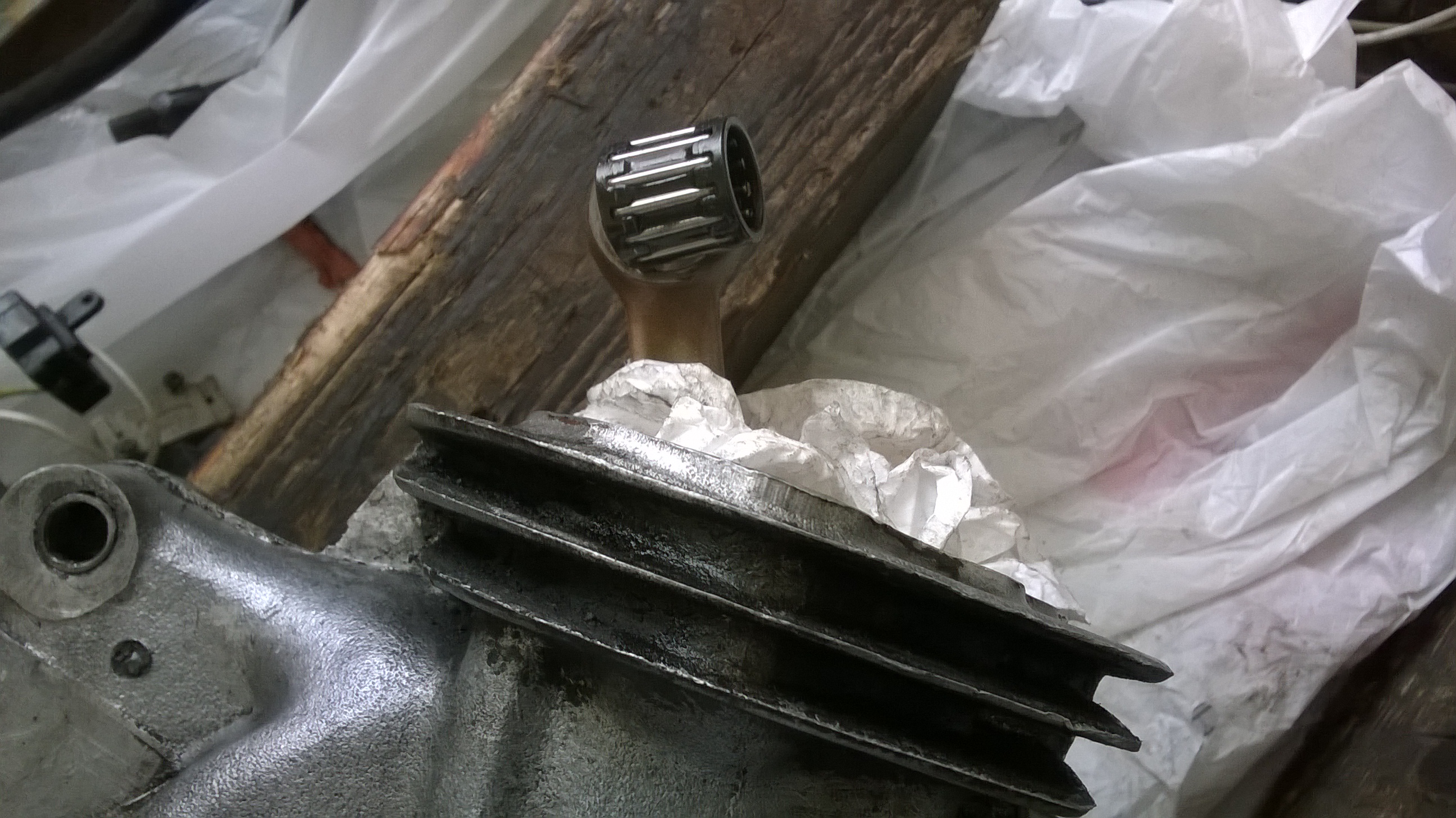

the 1978 TS had a needle bearing on the top end of the conrod.
These bikes had an oil ratio of 1: 50.
The old bikes like the ES 150 had a bronze bush, these bikes needed 1: 33.

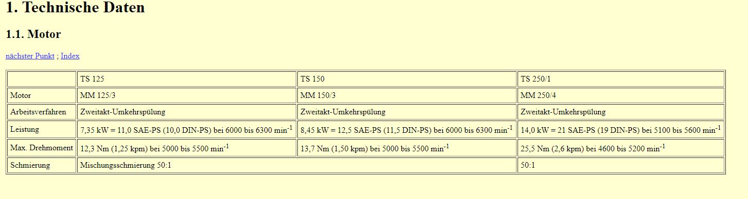

Postby Guesi » Thu Feb 18, 2021 7:00 am
At miraculis.de you find a manual for TS 125-250/1 from 1978.

Postby dave47 » Thu Feb 18, 2021 7:30 am
1980 ts150

Ta Dave, I'm not contesting that the thing has a needle bearing, I don't know, never worked on it. Note the OP's is '78.
