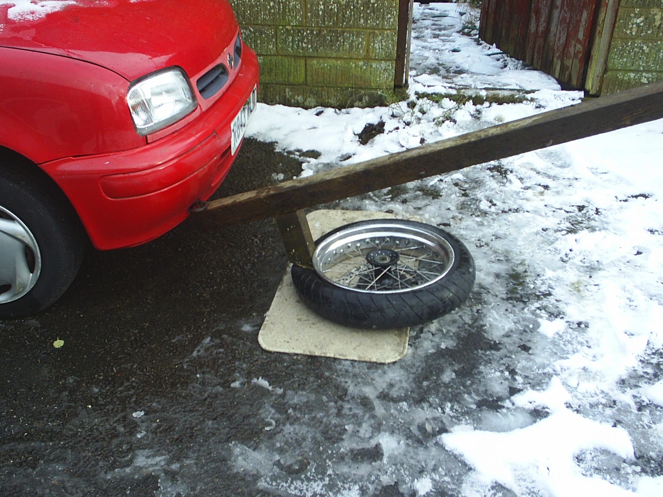

Postby breakwellmz » Sun Jan 24, 2021 9:20 am
So pleased with how well this worked, although i lifted the car wheel off the ground before the bond between tyre and rim gave way!

Postby AlanJ » Mon Jan 25, 2021 7:34 am
Hi,
Looks good, and obviously works well, but I just stick mine in the vice, works a treat.
Stay safe Alan

Postby Blurredman » Mon Jan 25, 2021 7:40 am
Looks fun :)
Personally, if it's a tubed tyre the tyres I use don't normally need a lot of pressure.. just my knees..
But on tubeless tyres or very old tyres of either build, then I normally jump on them with a spade.

Postby breakwellmz » Mon Jan 25, 2021 8:51 am
Hi.
A FOURTEEN (!!) year old tubeless tyre as stiff as hell!
I tried using the Beta prop stand to break it and just succeeded in lifting both wheels of the Beta off the ground so i knew it was a tough one!
The spade is an interesting one.
Once the bead was broken it popped off dead easy. :D
Cheers.

Postby DAVID THOMPSON » Mon Jan 25, 2021 9:59 am
the harder they are to get off to change them
the faster they will come off at speed with a sudden loss of air
note no surprise like loss of air on both tires at about 40 mph and they both come off the rims
alloy rims are slick :smt040
