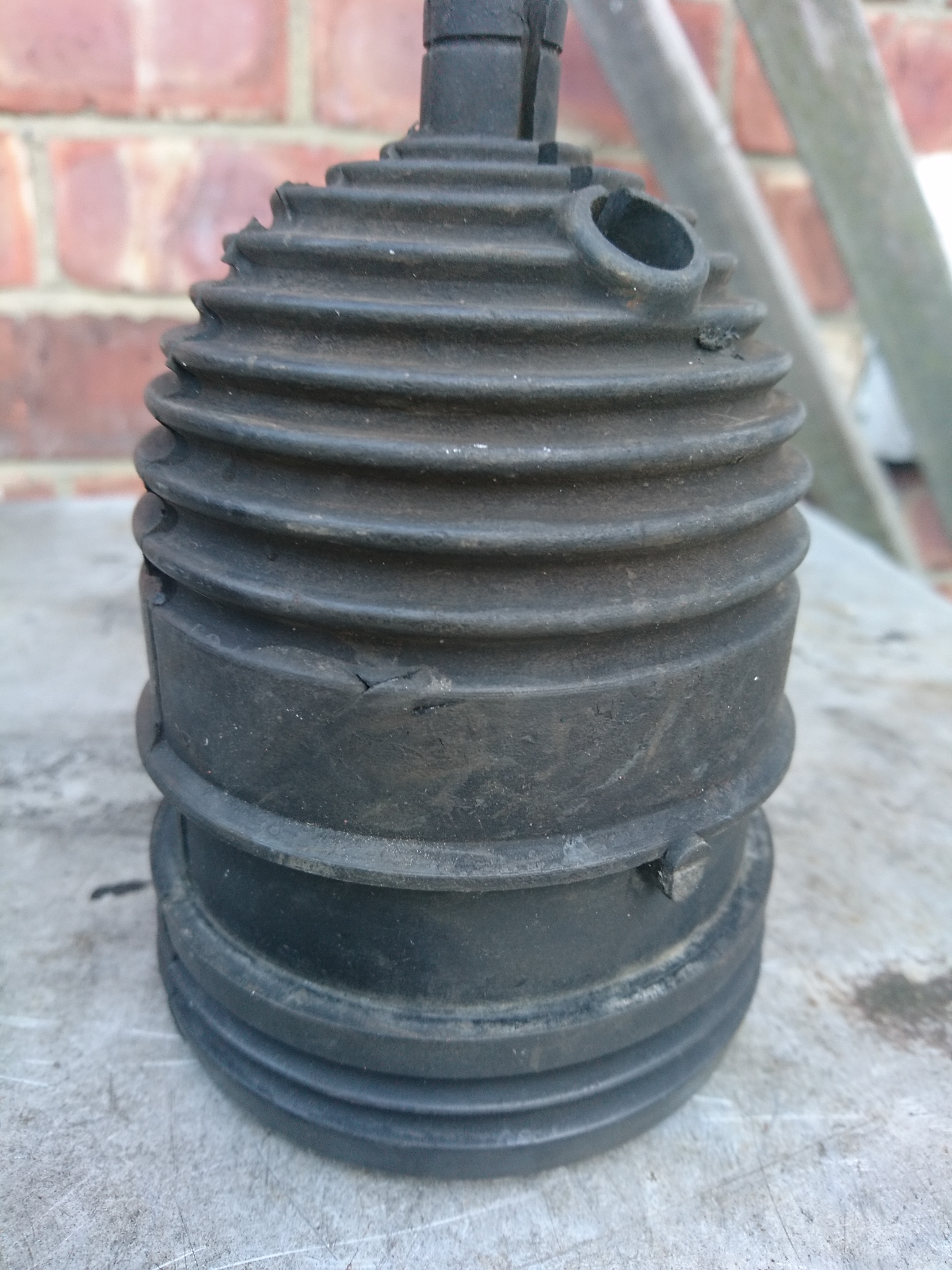

I think the rubber stuff that MZ have used has held up extremely well. Rubber clock mounts, the foot rests and gear change rubber and of course the front gaters that still don't have any cracks!

I too have the original front gaters on mine (1980), they are in great condition. Although, just as the rubber cups the gaters have gotten stiffer. Still even the cups aren't to bad.
On other old bikes they tend to get rock hard.
Only rubber pieces that didn't held up so well are the cylinder fin dampers. But I was able tu revitalize them.
Sadly, the new stuff is very poor quality. I recently installed a new rubber kickstarter stop. Now, after a few months its just as cracked as the 40 year old original one was.
