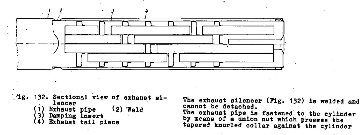

When you study the factory diagram of the the complexity of the original baffle system shown below, one gets a worrying feeling that the aftermarket copies aren't going to be anywhere near the same inside. It's very clever how the various length internal tubes are arranged. Each one will have a different resonant frequency and also different path lengths to the exit hole. This will blur the bang of the exhaust pulse after it has passed through the front and middle section of the silencer*, yet at the same time there is not really any barrier or restriction to impede the gas flow. The vertical bars are actually steel discs with a series of holes by the way.
*NOTE: This complex baffle is fitted right at the END of the complete silencer very much like a tail pipe muffler on racing bike expansion chambers but much wider. Indeed, the long front taper and midsection of the silencer are completely open/empty and unrestricted so what you have is a tuned expansion pipe system but disguised as a normal looking silencer....Ingenious as most things are with MZ design... :wink:

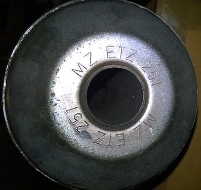

Of course all the fibreglass prevents a meaningful weight comparison. Here's the end cap of the original:
Original end cap.jpg (36.64 KiB) Viewed 444 times

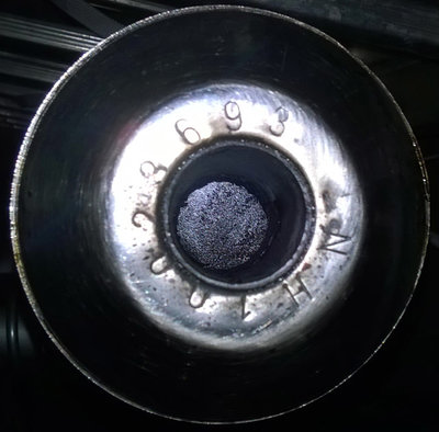

I forgot what I paid for my aftermarket replacement silencer, this is the end cap:
Aftermarket end cap.jpg (34.83 KiB) Viewed 444 times
It still looks fine, and no problems have appeared. Performance-wise I cannot remember any significant difference with the original. But if you want fast, best take another bike anyway, IMO. Or at least tune it properly, like they do for the race track, but that's not why I have an MZ.

Thanks Puffs for posting that aftermarket end-cap photo. I have just checked my one and it has the same numbers stamped on it. You say it performs well so that's reassuring.
So we have a reasonably good consensus that the silencer with NH10023693 stamped on the end is of decent quality. :)
