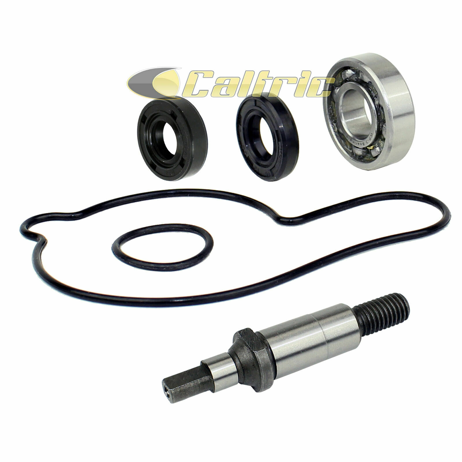

Postby breakwellmz » Tue Nov 17, 2020 4:59 am
Non that i can see.
This is the sort of thing i`m talking about, inner and outer seal that run on the shaft, if the outer one fails you see coolant on the outside, if the inner one fails you get coolant in the engine oil.
This is the Yamaha YZ450 setup, but they are all similar as far as i know.
