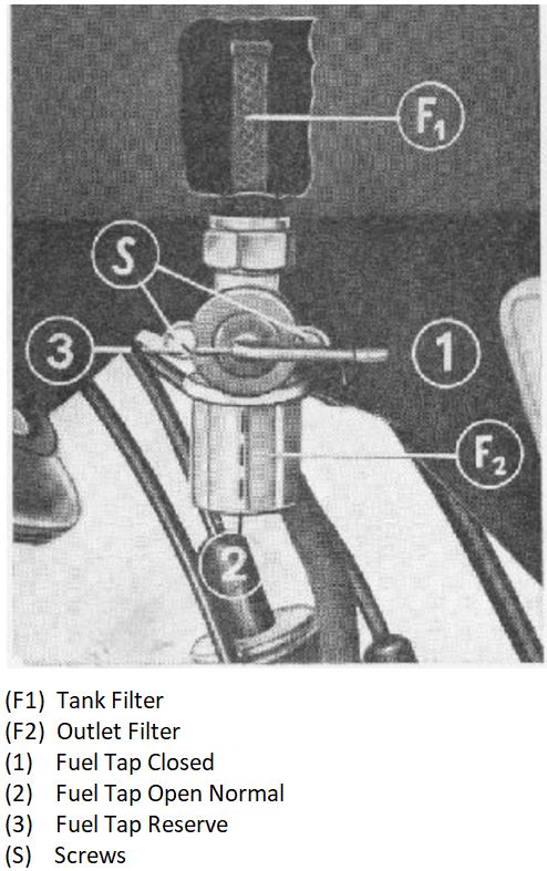

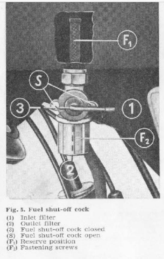

I was looking through several MZ operation Instruction books just to check the petrol tap functions. I was very surprised that on each edition the same erroneous descriptive details prevailed. :shock: See the original picture below and then I show the corrected version I made up:
I am amazed this was never corrected over all the time the English versions were printed....perhaps no-one ever read them? :D

It's hard to understand what went wrong...there are SIX labels and NOT ONE is correct... :roll: and this error was repeated for decades! :shock:
Les

I'm afraid the poor old British person was brought up not to complain, which is why today their very existence is under threat....sorry to be political. The original German versions, obviously, are correct.

I don't wish to cause a problem but my Saxon's fuel/ petcock is not like either diags for position, it has a handle bit which you use to turn it, with an arrow head pointy other end which points to the petrol position which is left is off, vertical up is full-on, vertical down is reserve. Now to be honest I can't get to my TS to see what is going on there. How is your Saxon Les is it the same as mine?

Hi Alan.Yes, the later models had a slightly different design but principally the same mechanism. My Saxon Tour petrol tap is bolted with two screws into the fibre glass tank. I have the user instruction manual but even that is not clear so I will check tomorrow on the bike. The problem is the diagram is not making it clear if the 3x positions of the tap relate to the handle or the arrow and because there is an up and a down position with reserve and normal ON if you take the instruction to be the handle or the arrow you could be on reserve all the time instead of normal only to find this out when you attempt to switch on reserve and find the tank is empty... :evil: . I'll have a look tomorrow to clarify as I have forgotten which way round it works, maybe the tap has writing on it..... :? Les

Good to see you have the bike running. Back to the fuel taps, yes my Saxon ones are marked off,on,res, and I looked at the TS last night and that doesn't
have any on-off etc, on it. You are right though Les that original diag is all up the shoot.
