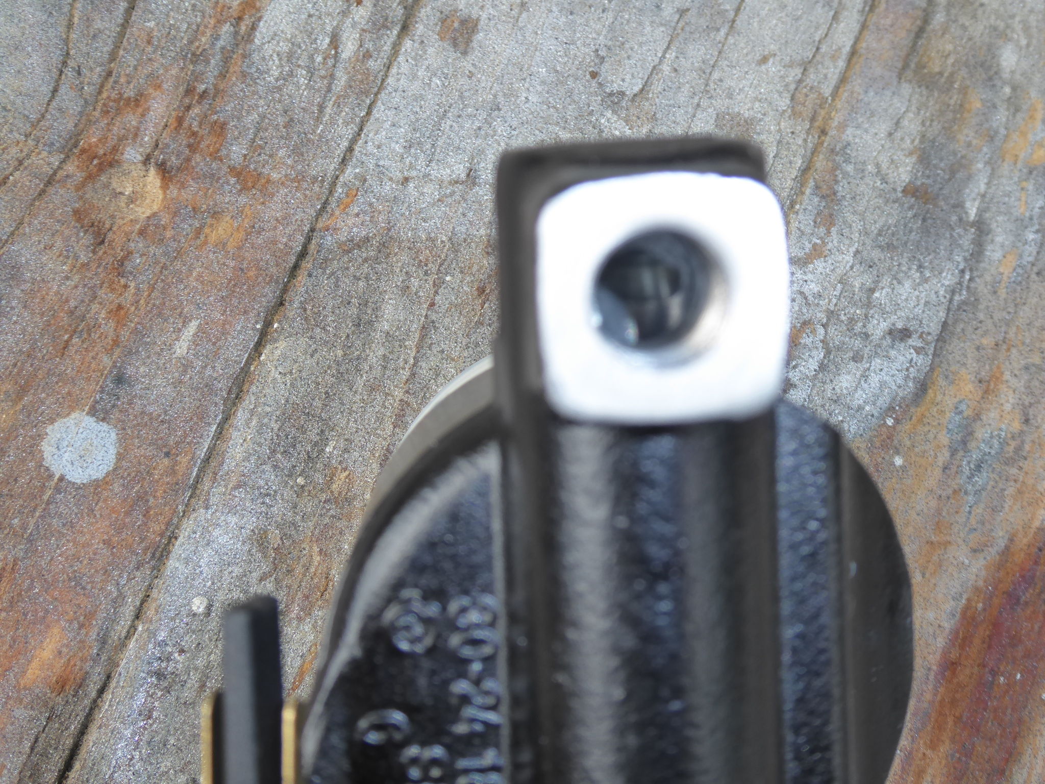

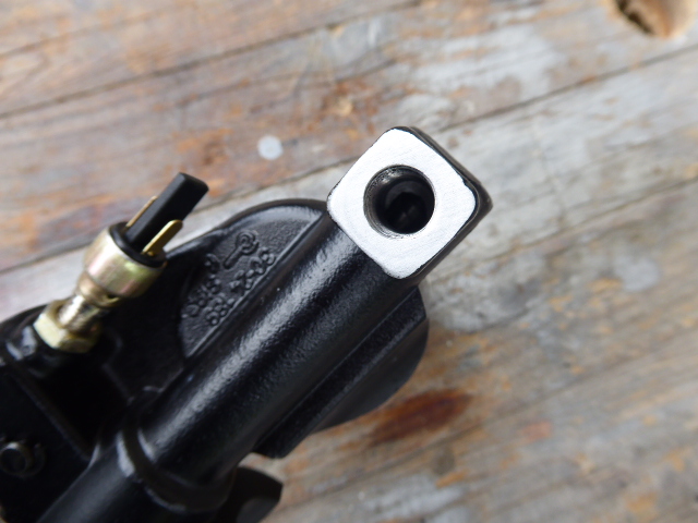

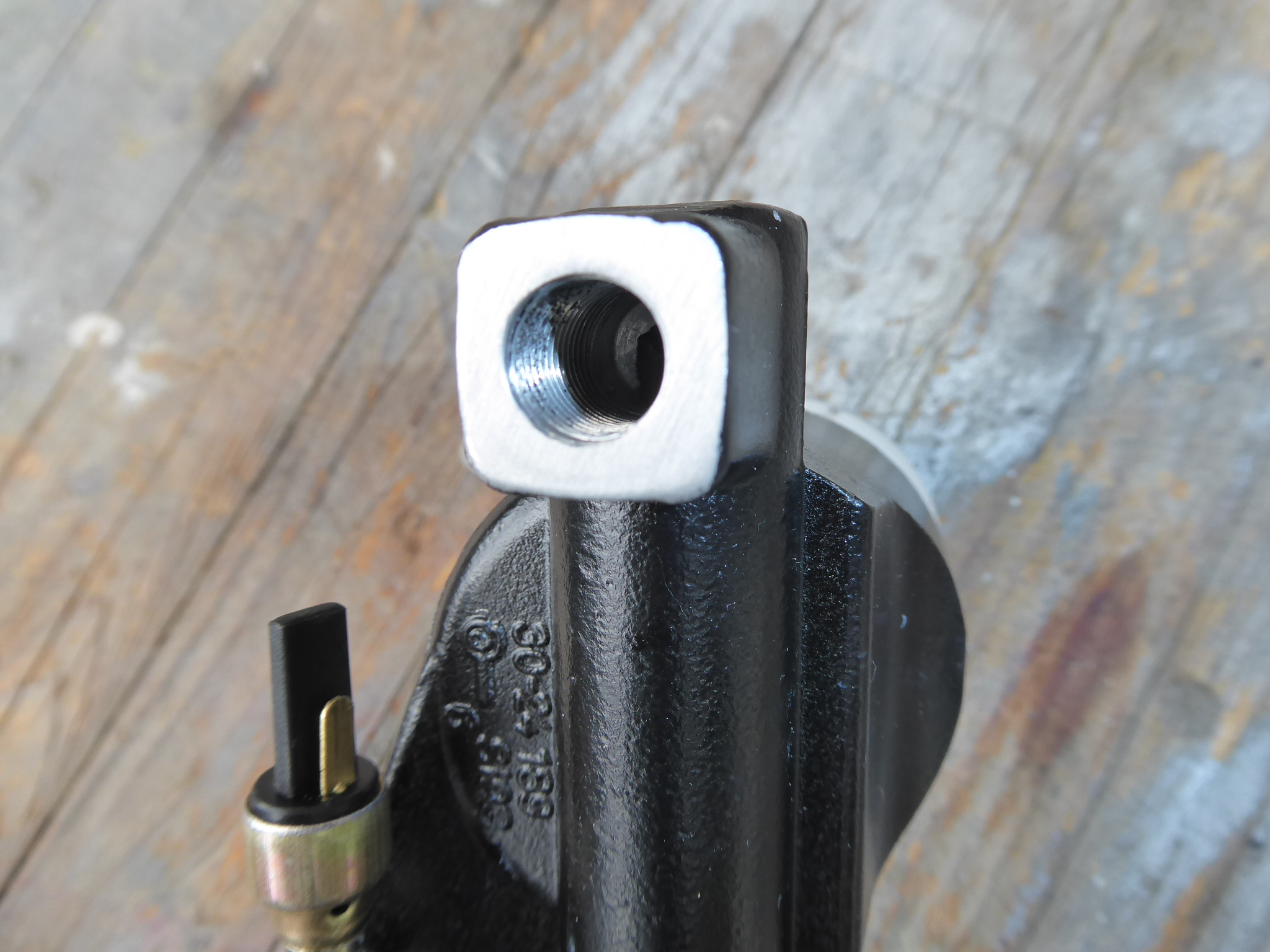

I just fitted the new master cylinder and the oil floods out of the top hose fitting...no matter how much I tighten it...in fact it has screwed all the way in to the flange of the nut so I can see something is wrong. I have now had to drain it down and remove it which is always a big worry with brake fluid dripping everywhere and stripping my new paint off. :evil:
Anyway it looks like the threaded outlet hole has been cut too deep and the "cone" shape seal has been half drilled away so the brake hose fitting has nothing to seal against...Surely this not correct or do the later ones rely on a washer between the body and the end of the hose nut fitting?
Please click on photos to help view the faulty seal:

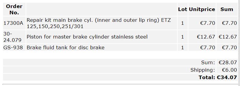

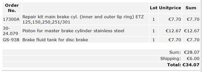

Many thanks Guesi...I have already beaten you to it :D ..... I already checked out your shop this afternoon and put these items in the basket, plus a new SS piston...See attachment.
I will have to add the O ring too..
I will put the order in to you pretty soon.

Regarding the NEW master cylinder I bought as mentioned earlier on this thread:
The seller says "they are all manufactured this way" and he could send me a copper washer to seal the hose.
QUESTION Please:
Do you think this would be satisfactory? The original master cylinder has a cone shape at the bottom of the thread so the hose can bite into it and seal whereas his new ones seal supposedly against the hose end fitting with a washer...I am not sure if this is normal hydraulic engineering practice? I am not sure that this will work that well in terms of reliablity and sealing...what are your views please? Much appreciate a good answer as I have to accept this item or return it but there are not any alternatives available....

The issue is that it is constructed (slightly) different from how MZ (/Brembo?) designed it. Your current brake line might not be suitable for fitting with a washer - or maybe it will. Indeed, no washer on mine, but it might still work fine.
On fitting brake lines with copper washers, I just had a look downstairs, and modern Brembo does it, as does Nissin. So it is a viable approach.
