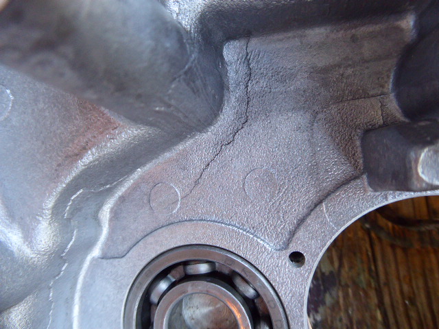

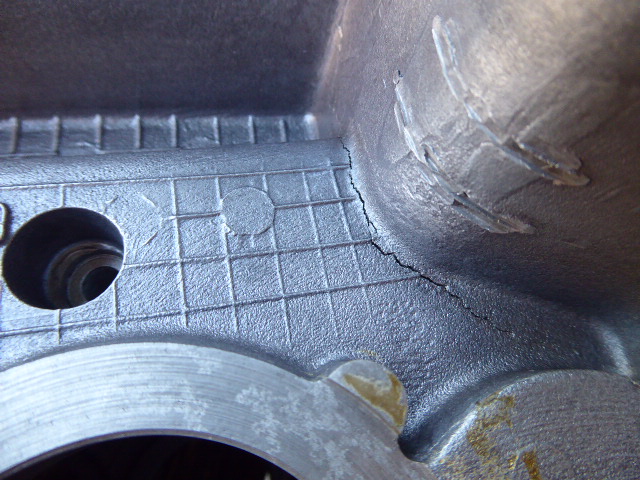

Just when I thought everything was going nicely I spotted a nasty crack in my cases just above the output shaft bearing :( :( :( :evil:
The crack is right through to the inside. It looks like at some time the chain has risen up and hit the case with a massive blow....maybe the spring link came adrift and allowed the chain to bunch up and jam against the casing?...You can see the chain has cut the case during the impact.
If you think about it, it must have occurred on the over-run where the chain is driving the engine otherwise the engine should have pulled through all the remaining slack cleanly. Fortunately (?) the position is relatively only slightly stressed but I will take it to a local TIG welder to have it welded both sides (pics to follow).
I was wondering if anyone had seen or had this happen to their machines? I would be interested to find out and hear any comments.

That is indeed very nasty, and I do wonder if the gearbox barings align properly? I wouldn't really worry about that though. It'll work out. :-D
I've not personally seen this, but it's very possible- It may have happened at quite a speed- or downhill (if you're thinking it happened at throttle off moment).

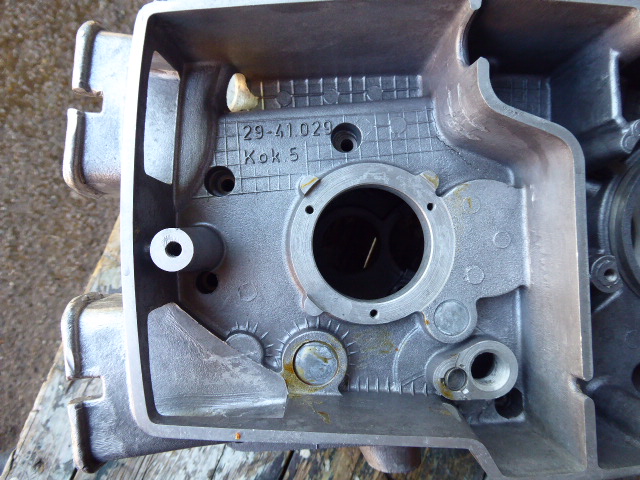

Also- Looks like you might need to punch the 10mm 'core' plug back in (adjacent to the Neutral switch). After taking the engine apart, they move after the selector assembly is re-installed. On both my re-built engines I have had to re-seal and seat these plugs, when before rebuild they never leaked.. Just for you to know if the future.

Hi Blurred man...Thanks for pointing that out regarding the selector shaft plug...I hadn't noticed that it was not in correctly....yes it's so maddening as the engine has only done 9000 miles which I can say is completely accurate as there is zero wear on any moving part but I'm doing a full strip down anyway mainly for the seals but will replace every bearing just for the perfection of it all...now the casing is cracked it's galling, but as said, the position does not affect any bearing alignment or stress point...Les

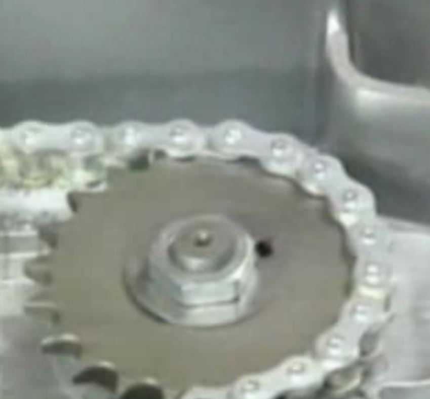

Just for reference to the chains proximity to the case (from the video):
It wouldn't take much for it to hit...but the marks on my case are quite a length and high up which seems to indicate a bunching up of the chain at this pinch point. The only way this could occur is that for some reason, (see further explanation) a couple of links had moved off the sprocket teeth and folded back onto the chain now sitting in those same teeth so had no where to fit back into. Perhaps this might occur with an extremely loose chain or, as suggested before, the spring-link had broken. The rear wheel sprocket could have fed the loose end of the chain shooting forwards through the rubber guard tunnels into the sprocket area of the case. The drive sprocket (still spinning) could have picked up the mass of folded loose chain and crashed it into the case wall...the engine was likely to have stopped instantly at that moment.... :shock:

Personally i would look for another case or use something like JB weld (epoxy) to repair the crack after first drilling to stop it extending.
Not sure how`weldable`this alloy would be and then you have the problem of potential distortion.

I agree with puffs. I was thinking you could assembled the two halves, maybe even with the gearbox in too for extra bracing inside and alignment holding (?) whilst the outside is welded up. ?

Sorry about the crack, I was about to post the same thing with putting the cases together but the other thing if I remember rightly, It's such a long time
ago, that there are different levels of alloy weld ie. if it's not structural, a weld rod with more silicon in it is softer but easier to fill a crack. I hope that's not a load of rubbish. if that is still relevant it might be worth mentioning it to the welder. Hope it all goes well Les. Alan.

The sort of thing I was referring to is, SIFALUMIN NO 15 4043
An Aluminium alloy with 5% silicon giving excellent flow characteristics and penetration. Suitable for welding: • Duralumin • Cast (LM25) and wrought alloys 6063 (H9) • 6061 (H20) • 6082 (H30) • Weld will discolour if anodised.
