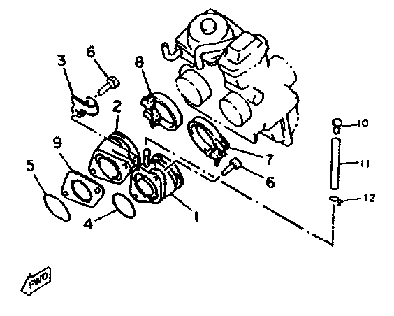

MZ traveller carburettor question - i took the carb off my MZ a few months ago and i am now rebuilding the bike, but i cant remember where the hose from the left hand inlet manifold connects to, see pic below? Can anyone help?

What on this bike is operated via vacuum? Fuel valve? Something in the emissions, like connected to the air box to scavenge?

On my Mastiff it`s blanked off but doesn`t it operate the fuel tap on a Skorpion?

my traveller has a hand valve/petcock it is a 97

I don't know the answer to this riddle, but elsewhere on the bike there should be a similar connection, which is now still open...
Don't ride with that manifold connection open (mixture too lean), but if it starts (choke), is there anything that doesn't work?

Well, maybe it is #11 in
Supplies vacuum to carb 1? Or plugged with #10?
See http://www.miraculis.de/aw/download/mz/skorpe.zip.

I would just blank it off it may be a vacuum connection for a fuel tap used on a Yamaha model, XTZ660 or SZR660.
