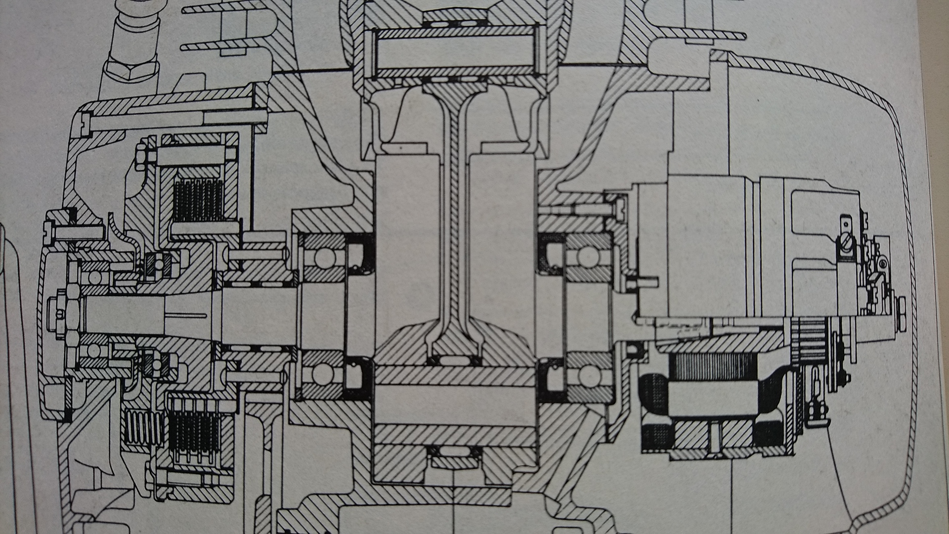

Postby dave47 » Tue Jul 14, 2020 9:37 am
Of the 4 possible ways to insert the oil seals, MZ may have used 3 of them for the MZ250 alone.
Springs facing out - 4 speeds
Facing right - Supa5 (according to MZ engine drawings)
Facing left - ETZs
I don;t know if they have ever made an engine with the 4th method but other manufacturers certainly have.
Obviously the seals have to seal in both directions and I imagine its just a case of which the designer decides to prioritise. Air leaks, oil leaks or fuel air mixture. I don't suppose the MZ seals have a hard life compared to some, and can probably cope whichever way they go in.
Some years ago I realised after assembling an ETZ engine that I had put both seals in the 'wrong' way round. I decided to leave it, and it has made no difference that I am aware of.

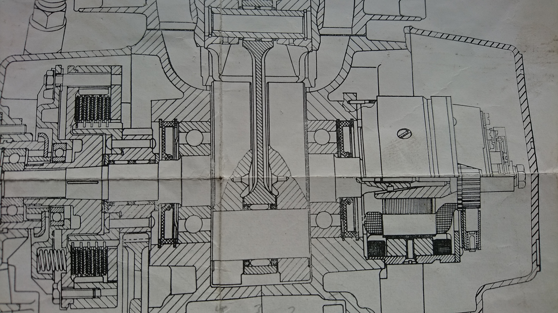

Postby dave47 » Tue Jul 14, 2020 1:56 pm
springs facing out
springs facing right
It isn't clear whether Supa5 seals were ever actually fitted this way.
I have no picture available of the ETZ engine but seal fitting instructions can be found on pp 34-35 of the ETZ250 Workshop Manual. It says both springs are to face left.
