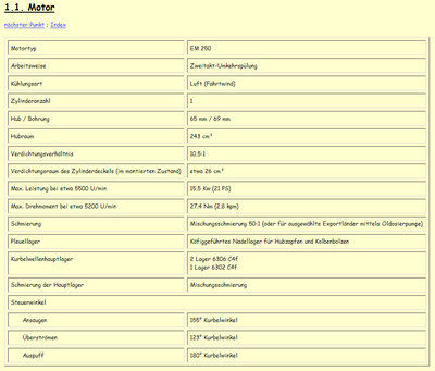

For completeness, the following from the official manual (Kurbelwellenhauptlager = crankshaftmainbearings):
Technische Daten EM250.jpg (32.48 KiB) Viewed 645 times

(Zoom to see the suggestion of open bearings, which may also follow from the name code.)

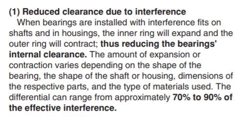

A very informative attachment Puffs. One very important point is the interference fit aspect....I can only assume this has a bigger effect on running clearance than I imagined:..I feel happier choosing C3 sizes now...Les

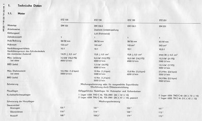

In an attempt to clarify, I had a look at the "Reparaturhandbuch MZ ETZ 125, 150 & 251.pdf", which is dated 1/07/'89, so just when the wall was about to fall. I think that's the latest official manual there is on these engines, but still in DDR times. The EM250 engine and the EM251 engine are largely the same (with some differences in the barrel). There I find:
Technische Daten EM251.jpg (19.55 KiB) Viewed 645 times
C46??? What is that???

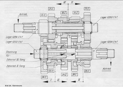

And they seem to have a certain predisposition for these C4f's - they also seem to use them in the gearbox...
EM251 - gearbox also has C4's.jpg (32.03 KiB) Viewed 645 times
I agree with what Kruh says, and I'd put C3's, as I think I did many thousands of miles ago (something like 20k miles).
