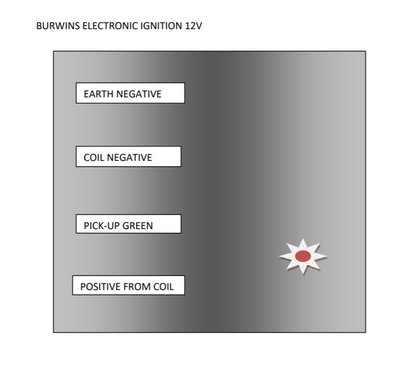

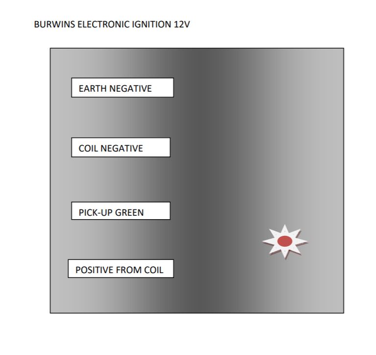

Hi Chaps...I was looking amongst my files just now and came across this diagram I made up after I searched long and hard to find this information and eventually spoke with Martin who found the data. It might help someone in the future. The LED position will provide the orientation of the tags. By the way, if someone had the full installation instructions for the system I would be very happy to see them here. Much obliged....Les
