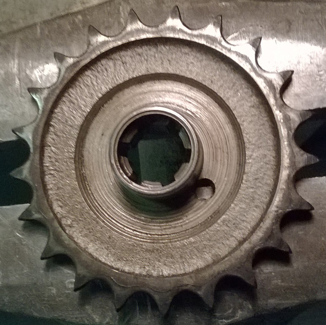

For a start, As far as I know the front and rear chain sprockets were original. I had previously changed the chain 13,000 miles ago with a 2nd hand one down from my brother which had only 10,000 miles on it. I was replacing one which I had no history on, so I thought it best to be safe with a 10k mile rather than potentially 30k at the time. So that 2nd hand chain is time to go!.

Whilst the wheel was off however, let's go back to that chain! Let's check that rear sprocket.. It is worn, true- but it seems to have a fair amount of life left. If both front and rear sprockets are original- the rear has turned a lot less than the front!
And so to the front sprocket- what does that look like? Well.. Like this:
I would have continued to use it, potentially for another 5,000 miles maybe, but I know I have a NOS same tooth sprocket that I purchased in Hungary some years back. But, upon proper inspection there was a crack in one of the tooth, and so- I decided to use my replacement. I must mention that I did purchase an ETZ250 chain, so had to remove a link of the new chain before installation!

- The rear sprockets are good quality & last a long time. The one on my 251, at 35k mi, is also definitely original. That front sprocket too seems original. Yes, it has some wear on the sides, but still, after such a distance (+ several worn chains) it could have more wear inside the teeth. For comparison mine, which I replaced (for a smaller one, rather than for wear) after 30k mi:
- Yes, front sprockets rotate more often than the rear (by that gear ratio), but normally front sprockets are harder steel. Low power, good shielding from dust, finer sprockets and good quality help longevity!

Your front sprocket looks good, still life left in that- more than mine at least. Like I mentioned, I might have continued to use mine if it wasn't for the chip. I was considering still using it anyway because the chip was on the rear of the driving tooth so would get less contact anyway. But.. I have a NOS sprocket that can potentially last 50,000 miles... what is 5k more on the old one? Let's just replace it now I thought.
What interests me is that I fully intended to replace the chains every 10,000 miles mainly because the chains are so cheap to buy £10. But I think it's likely a chain could last maybe 30,000 miles in an MZ if properly adjusted and lubricated often enough (would using Moly grease be better than generic green grease?).. But I woudn't like to stretch to 30,000 miles- even in an MZ it seems it could potentially be pushing it a bit? The downside of the fully enclosed chain on an MZ is that if the chain breaks, there is 100% chance it will snag something up, whether it gets caught in the back wheel or the front sprocket - unlike an open system where there is a fair liklihood that the chain can simply be thrown onto the road..

I can't see that chip in your sprocket. What happens (can happen/has happened to me) is that a tooth breaks off. Then, when the engine pulls on the chain, because of the extra play caused by the missing tooth, you get jerking & much higher loads, causing rollers to break, and potentially the chain to break. And then it gets more expensive. Yes, on the ETZ with it's enclosed chain, the rear cover is likely to explode, on other engines with less room around the front sprocket, the chain may wrap around the front sprocket & ruin the engine casing (if it breaks @ the rear end). Even more expensive.
But normally teeth breaking off would only happen after much more wear, and will probably require more torque than a 251 can give - unless there's a crack or material flaw. Anyway, it's an incentive for sensible maintenance on the journey to achieving Zen.
There is definitely a difference in quality of chains - some last much longer than others. Grease: I wouldn't know. I used to use old engine oil, nowadays any dedicated chain spray.

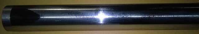

Edit: see one of my stanchions which I replaced a few years ago, after having done some 30k miles:
It's a bit difficult to see, but there is wear, particularly on those places where it carries the torque when you brake. At the lower edge it is clearest, you can see the wear patch just above the tapered section.
I replaced them primarily for corrosion between the triple clamps (not shown), but it also reduced the play in the forks. And made them better.

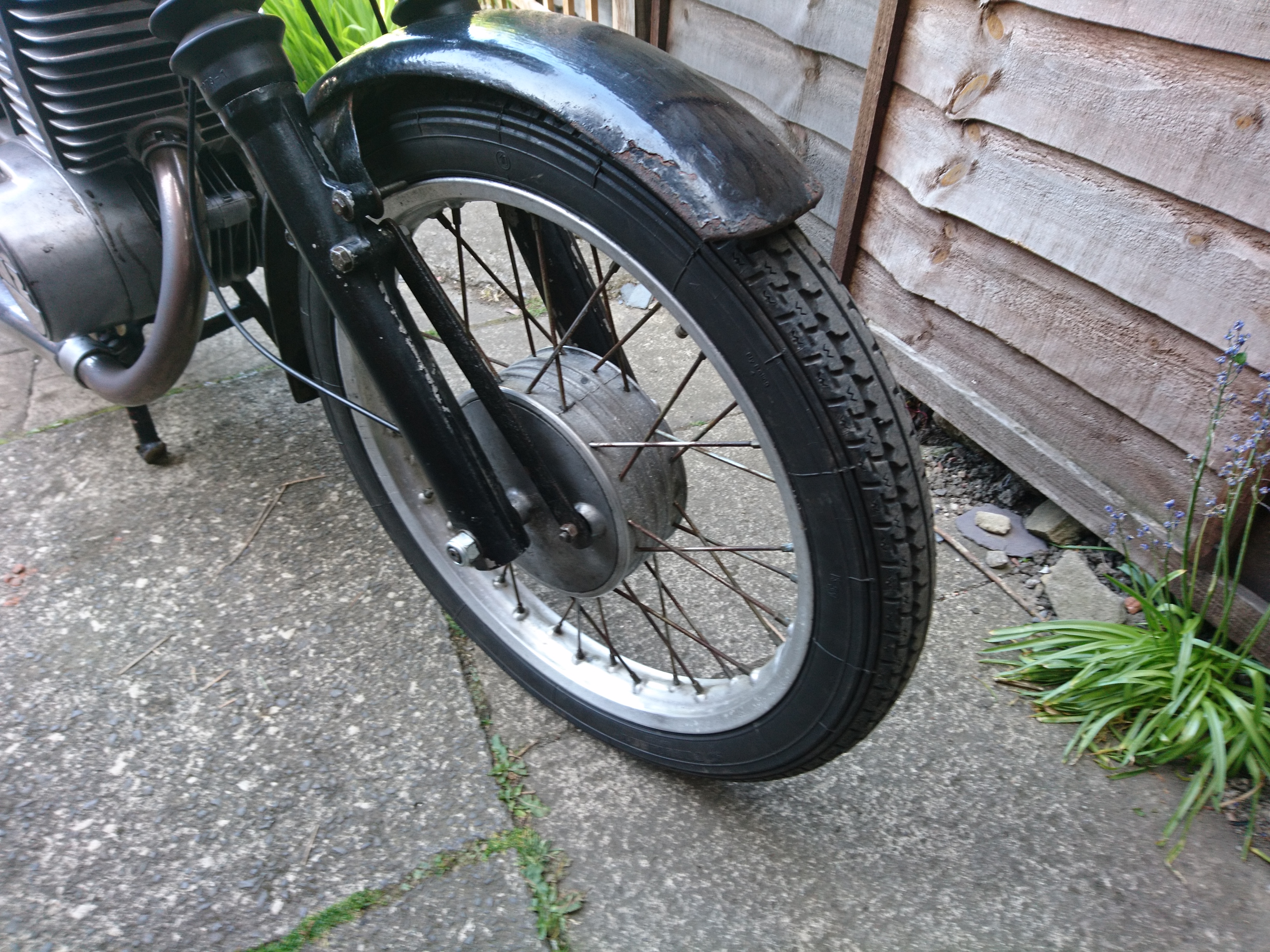

Is picture 2 of the Heidenau? I had not heard of Dura tyres before. I see that the HF319 is belt biased which is rather unusual for the old school tube tyres we use - mostly crossply. What is your front tyre in the last pic. It looks even more chunky than a Mitas H03.
I needed a front tyre in a hurry for an MOT and dragged this 35 year old Pneumant out of a dark place. It has no obvious sign of deterioration, and I have just done 20 miles on it. Don't worry, I will replace it before doing too much mileage

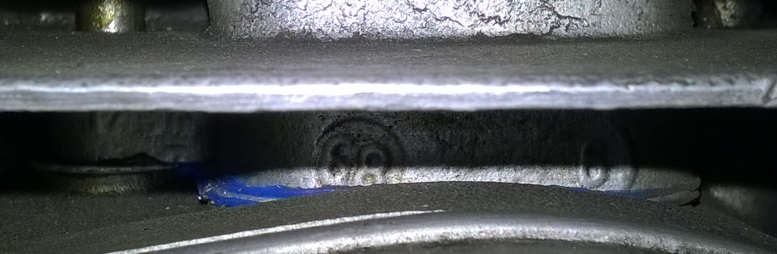

How fortuitous you mention Loctite bearing fit... I recently had to use the same compound on the rear wheel of my Honda.. It wasn't a terribly loose fit, infact smaller than my feeler guages went down to- but the bearing fell out when the wheel was facing down. I was worried a little about using it and wondered the difficulty in removing said bearing if I ever had to replace that one.. Have you ever removed a bearing that had been fitted with bearing fit?? Apparently the sheer sideways force is quite weak so shouldn't be too much of an issue to hit out.. I'm semi-tempted to buy a bearing just to see...

Loctite: they claim bearings can be removed when required with hand tools, but I have never tried it.

On the markings on the foot of the barrel: are we really sure this is how those numbers should be interpreted? That would mean my barrel was produced in September '89:
Apologies for the shadow, but it does say either 9 89 (if read upside-down), or 68 6. Problem is, the V5 says "Date of first registration: 14/08/1989". It is possible, but then it had a new (original) barrel before I got it, in '98, with 8500 mi. That is possible, but it seems improbable.
Btw, see the 1mm plate at the foot, w/ silicone gasket at both sides, to increase Maß A from 13 to 14mm. See an older thread on barrel differences 250/251; did you measure yours?
