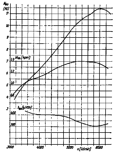

Yes if the spring is weak and lost it's preload, it might not keep up with the cam movement so that the coil's charge time is reduced & points may make poor contact. It is not a problem I have ever had, and these engines are not particularly high revving:
Bild 5. Vollastkennlinie des Motors MM 150_2= max. Leistung, max. Drehmoment und spezifischer Kraftstoffverbrauch
Yes, an electronic ignition (of any of the designs) can improve the ignition and fix problems. But I think these bikes can also run fine with the standard ignition, and they have done so for many years.
