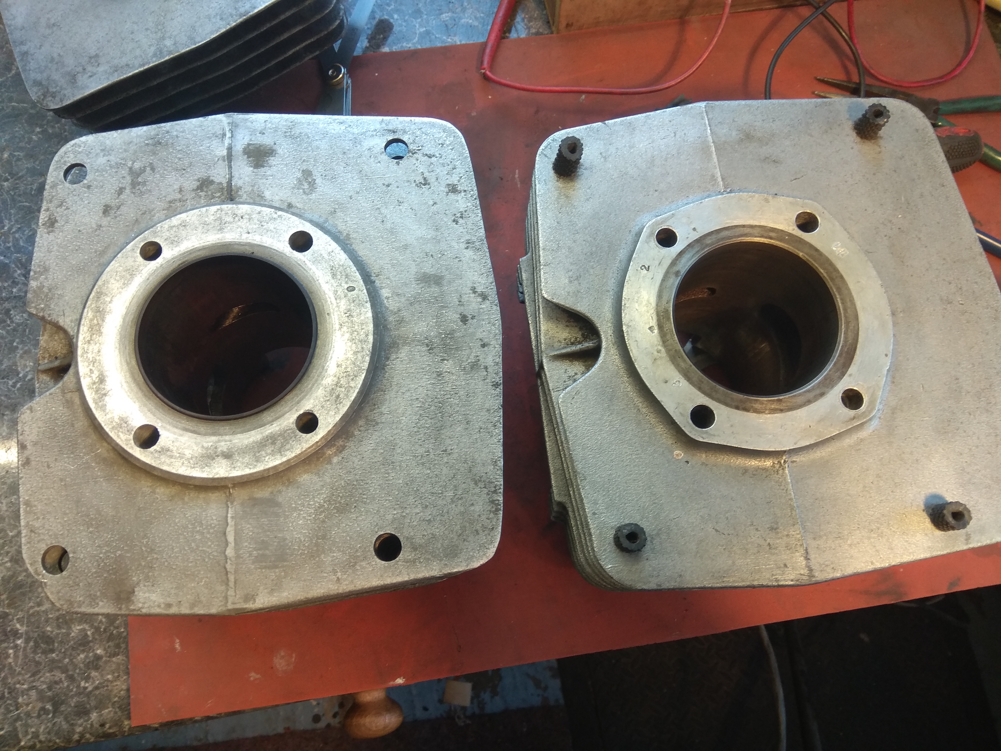

Wel lI've pulled the barrel off and it seems to be very different from the ebay one. I suspect I have an old ts250 rather than the 250/1. Question is will it fit. Although it has been rebored once the diameter is very different from the orginal, as shown in the pictures. It's a real shame as the 'new' one is in far better condition. As ever any infomation wil lbe greatly recived.
Many thanks Dave

Re: Piston choice for ts250/1
Postby Guesi » Mon Jan 20, 2020 12:32 am
Which one is the new one ?
Can you post pictures of the intake side ?
And how is the diameter of both ?

Postby Puffs » Mon Jan 20, 2020 6:54 am
Yes, there are some differences in the casting between the two; please tell which is the one you bought (and is it a 05-42.062 ??). The one on the right seems to be identical to the pic above, taken from "MZ_TS250-1977-Official_Service_Manual.pdf", taken from the section on the 4-speed engine.
On your question if it fits: the differences I see should not necessarily be a problem. I do not know if the barrels from the 4-speed & the 5-speed engine are different, and if so: how? Anyway, measure & compare all details (including porting, distances stud holes, height of the barrel), and maybe try to fit with an old piston, just to see how it all fits (fit, not start).
Further to Guesi's Q's: if the one on the right is your old one, why not just rebore that one?

Postby Guesi » Mon Jan 20, 2020 7:19 am
They both can be rebored as long as it is not already on its last oversize.
