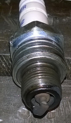

Plug with #138 MJ (fair test).jpg (25.36 KiB) Viewed 1053 times

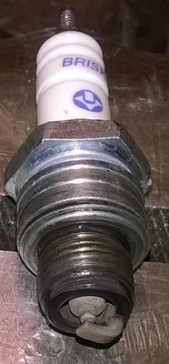

For now I landed on a 1.40mm one, giving:
Plug with 1.40mm MJ (fair test).jpg (30.38 KiB) Viewed 1053 times
While I'm showing these plugs, for me most important is the subjective impression of how the engine responds. And I do have the impression the low & mid range pickup is stronger than with the original 30mm BVF. This is not due to the size, as in that range the throttle is only partially open. But: as said, my experience so far is quite minimal, maybe 25 miles, and all at temperatures near freezing. Because of those low temperatures I may choose a smaller Main Jet under normal conditions, but for now I'd like to err on the side of caution.

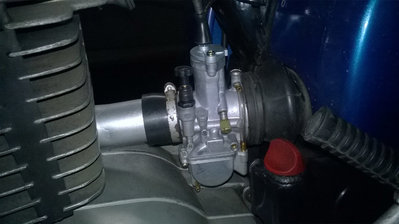

How it looks on the bike. I replaced the choke with a cable one to make it more like the original

Yes they look like cousins, but your awkwardly named new one looks better!
I actually prefer the Japanese-style choke on the carb: fewer cables. Indeed, less original, but if you want original best stay with the original BVF. Which I might actually do, as for me the PWK makes little difference in how the bike runs. Maybe slightly stronger on the early pickup, and broader, that's a pre, but in top speed the 30mm BVF seemed quicker. I'll re-test later. (My PWK was a 32mm, and my bike a 251 with a 1mm raised Maß A = 12.9mm barrel.)

Re: TS 250 PWK carb
Postby Puffs » Thu Aug 12, 2021 4:20 am
Thanks for sharing your experiences with these carbs Kruh, and all these details!
From my side I have nothing new to share, I removed the Koso after a relatively short mileage; not for any failure or so, but just because the original BVF is fine too. Maybe more surging on the overrun.
