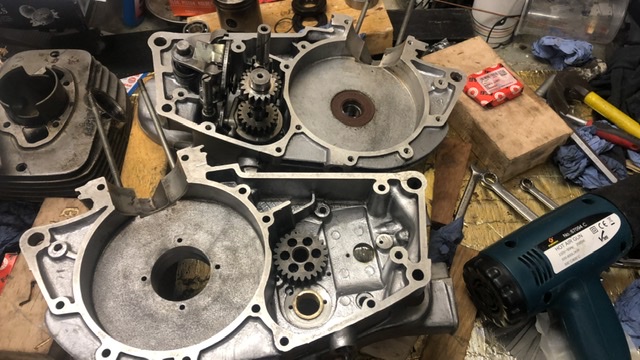

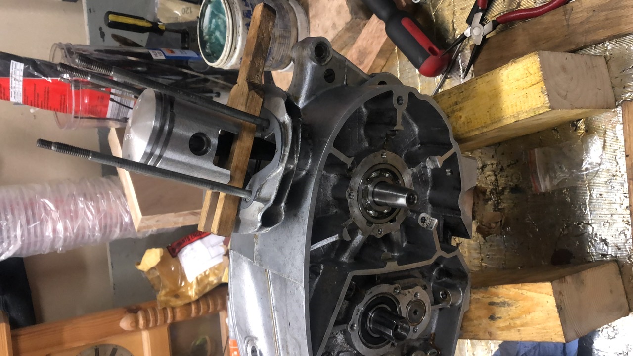

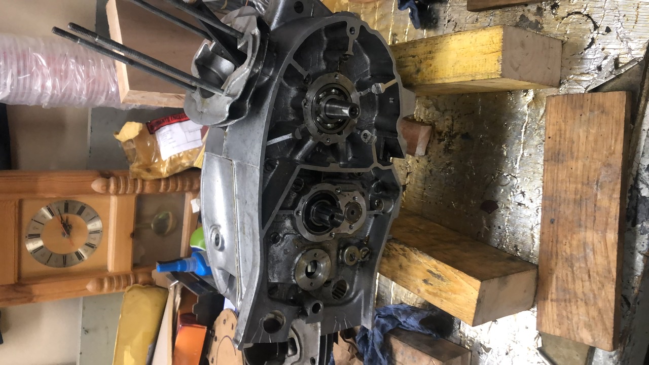

Right, back at it; new seals in and all new bearings fitted, cases reunited without drama which makes me suspicious somethings not right.
Crank turning super smooth, well centred and not touching anything, so that’s good. Only issue is the new brass bush for the layshaft is tight so shaft cannot be spun by hand but will turn ok with the sprocket on so hope it will loosen off.
New piston fitted too.

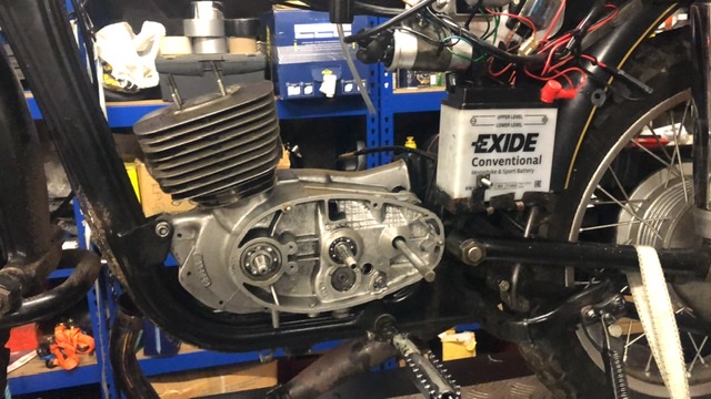

Postby ScotBob » Tue Jan 18, 2022 4:20 am
That’s the engine back in the frame final assembly to go and nearly there.

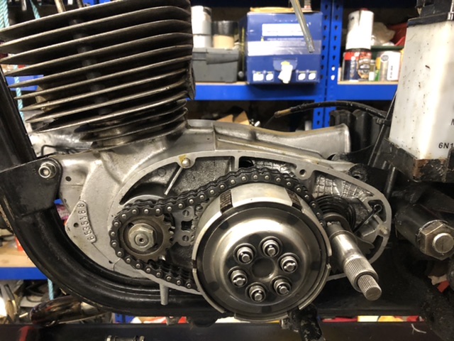

Postby ScotBob » Tue Jan 18, 2022 4:22 am
Even closer now:

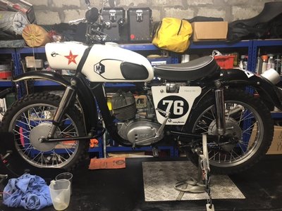

Postby ScotBob » Tue Jan 18, 2022 9:22 am
That's it done; starts easily hot and cold, idles nice, revs cleanly through the range, pulls like a train and going better than it ever did. Running it in a little richer with the needle up a notch until it beds in then i'll drop the oil and see how it looks, but to be honest i'm delighted with the result it's like having a new bike, well worth the effort.

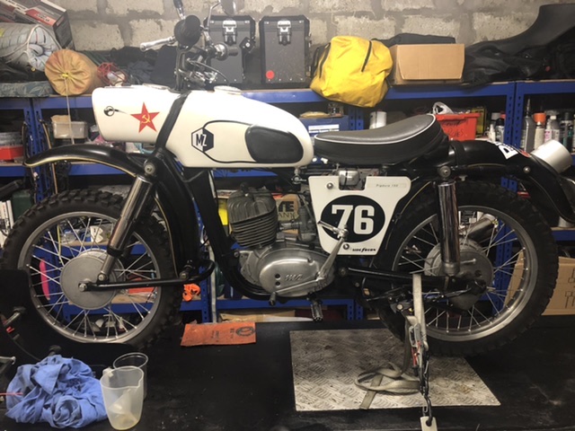

Postby ScotBob » Tue Jan 18, 2022 9:36 am
That’s it fully assembled, running sweet and cleaned up ready to go, thanks to all for advice and comments.

Postby Blurredman » Wed Jan 19, 2022 5:32 am
Congratulations! I bet you can't wait to go for a ride.
Question: Is that left rear shock on the correct side of the swingarm at the lower mount? I often see people put it this way you have (or previous owner has) but it looks a bit odd to me- surely it should be mounted on the outside of the swingarm, even on this model of bike? :?:

Postby ScotBob » Wed Jan 19, 2022 5:39 am
Puffs wrote:Ooooiihh...! It looks gorgeous!
Congratulations with the result & your work.
But: what was it? Which of the issues you found caused all the hassle?
Hmm, therein lies the question?
Crank seals: one was badly worn and both not seated correctly, neither were flush with the casing both were angled and not flat( ie one end protruding up above the indent for them in the crank case.
Bearings: significant movement in the layshaft bush and all gearbox bearings hence the gears contacting the casing (swarf). Evidence of the crank bearings spinning in the casing i.e loose, in fact the surface needed a bit of finishing to remove a lip that had formed. New bearings fitted with bearing glue to ensure a tighter fit.
Evidence of the crank contacting the casing but I do not believe this to have been during my ownership as I’m sure I would have heard / felt it. It may be the noise stopped after the groove had been worn? Crank looked to have been running off centre I’m guessing this maybe caused the bearings to go off centre and work loose potentially partially dislodging the seals? I measured and checked the crank before it was reinstalled all looked good.
There was partial plugging of the crank vent but I would have thought it was insufficient to cause the overpressure as I checked this with an airline before disassembly and there was clear passage of air but perhaps insufficient?
There was some scorching of the piston skirt so a new piston kit was installed, piston and bore were still to the original spec.
I can only surmise a combination of the above caused the issue, engine unable to breath fully, mixtures wrong due to loose bearings and unsealed crank seals and potentially a timing issue from an off centre crank?
But to be honest I am delighted with the end result and it really does go well now, so it was worth the effort.

Postby ScotBob » Wed Jan 19, 2022 5:47 am
Blurredman wrote:Congratulations! I bet you can't wait to go for a ride.
Good spot, it’s mounted in that manner as the bike does not have the original rear subframe. The subframe fitted is from an MZ enduro, the bike was a standard ES built to look like an enduro rep. The mounting was changed to keep it in line with the new subframe.
