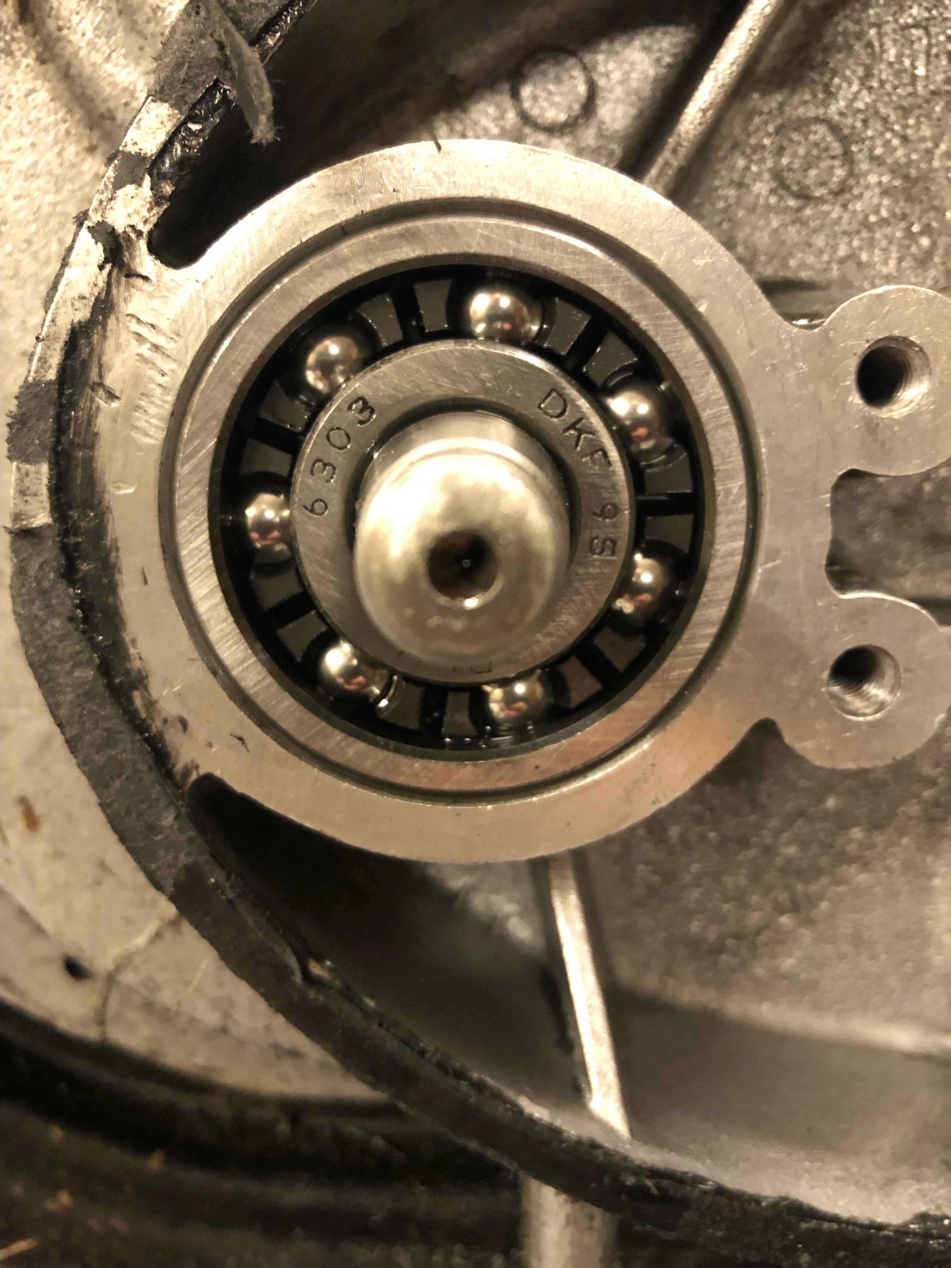

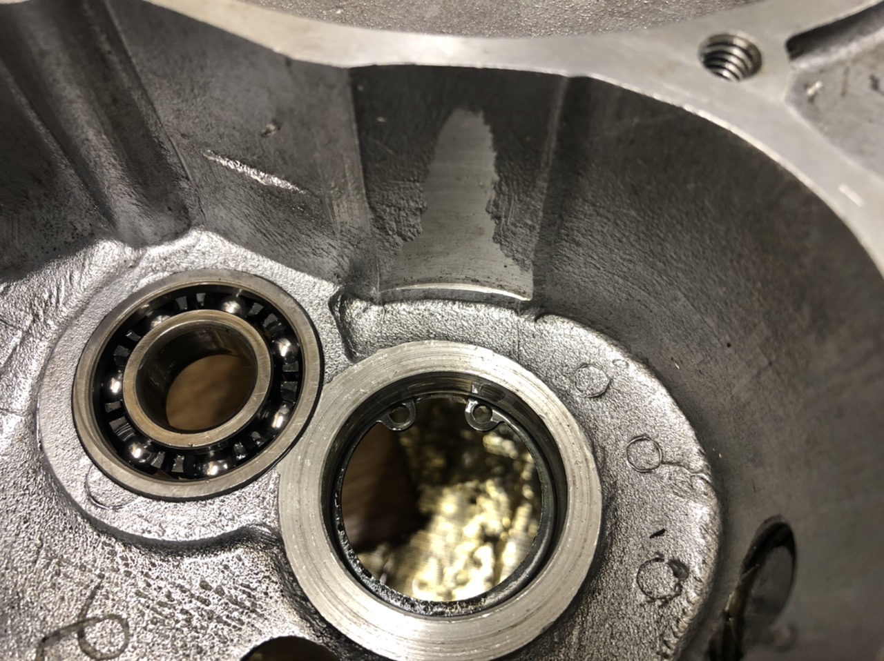

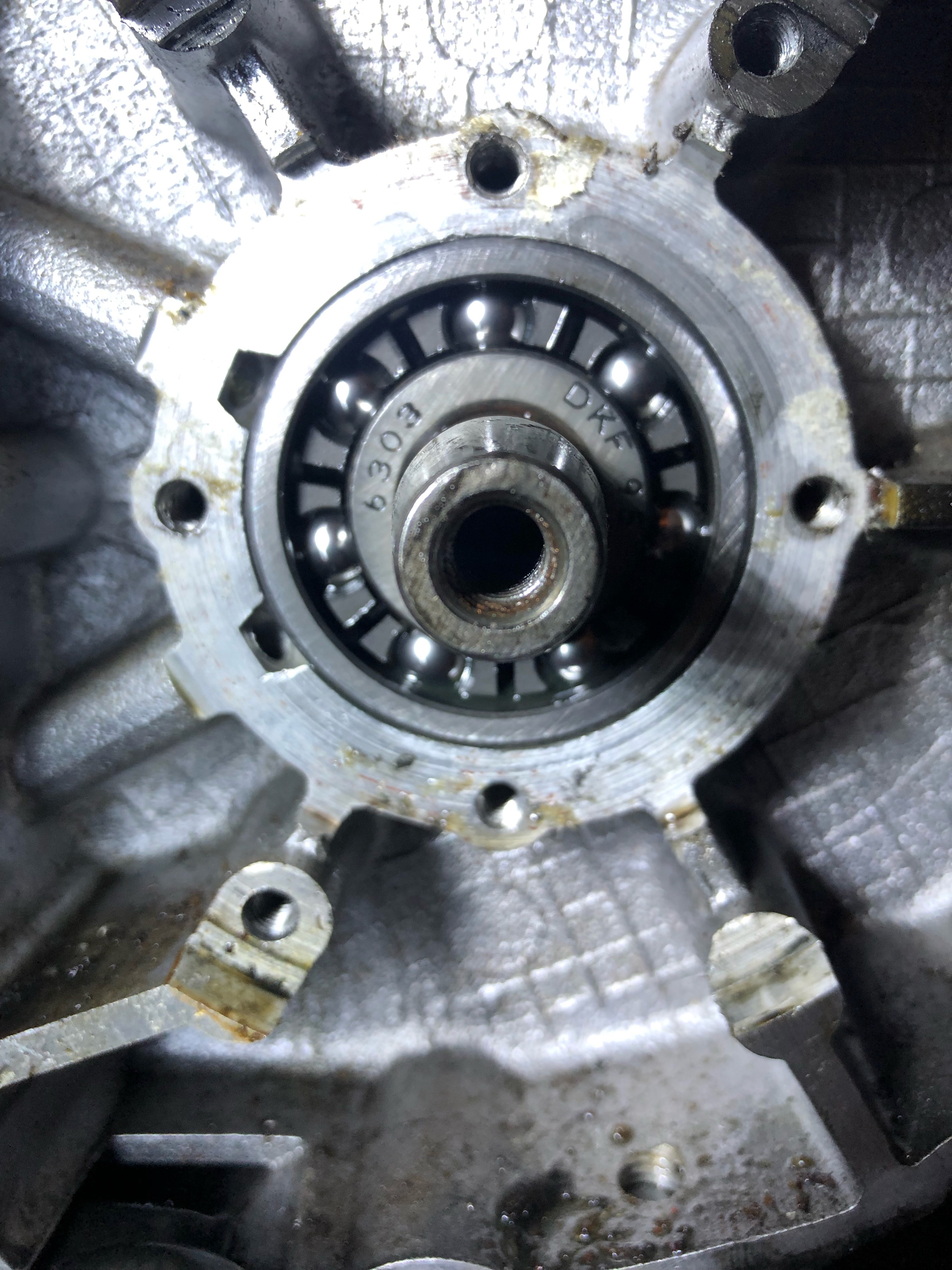

Well, I have stripped down the engine enough to expose the main bearings on both sides and both appear to be intact, nor can I detect any movement in the crank shaft.
I did notice that the LHS bearing is sitting proud of the casing and not flush but the RHS is flush however it's the side with the shim, gasket and cover cap, so not sure if the LHS should be flush or not, i'll need to read up on that for the rebuild.

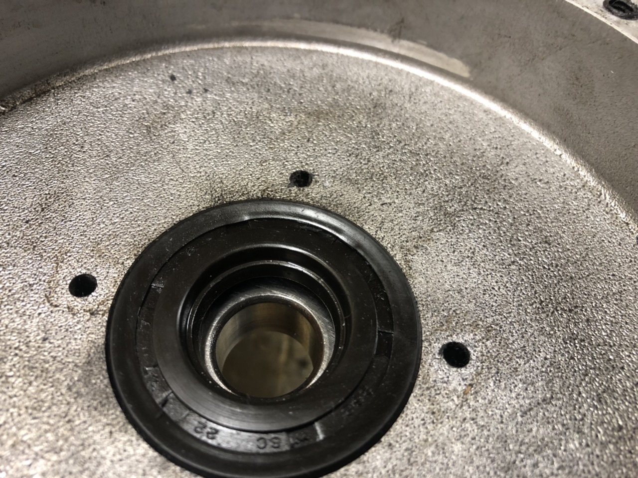

Ok, engine split and disassembled and the clues are there as to the issues. Firstly the motor literally came apart in my hands, all the casing screws were hand tight and the casings just lifted apart no tools persuasion required, even the crank came out easily.
There is clear evidence of the crank scoring the casing as it’s ground a groove in it, this must have been before my ownership as I’m sure it must have been audible the noise has stopped I guess as the groove has been cut and no longer makes contact.
Both main seals are misaligned and not evenly seated, the RHS main bearing is shot, it’s loose in the housing and moves in and out the layshaft bearing just fell out as I split the casing.
As for the swarf, the gears are grinding away the casing over a large area so clearly not aligned or adjusted to spec and possibly a bearing issue as again the gear shaft bearing fell out by its self whilst taking the gearbox out.
So numerous issues to deal with, new bearings and seals all round as a start.

The only thing I can add to this, is the bearing behind the removable cap is indeed to be offset but with the help of the shim to be butted against the inside recess of the cap. I know this after doing the same proceedure on my es250 recently.
