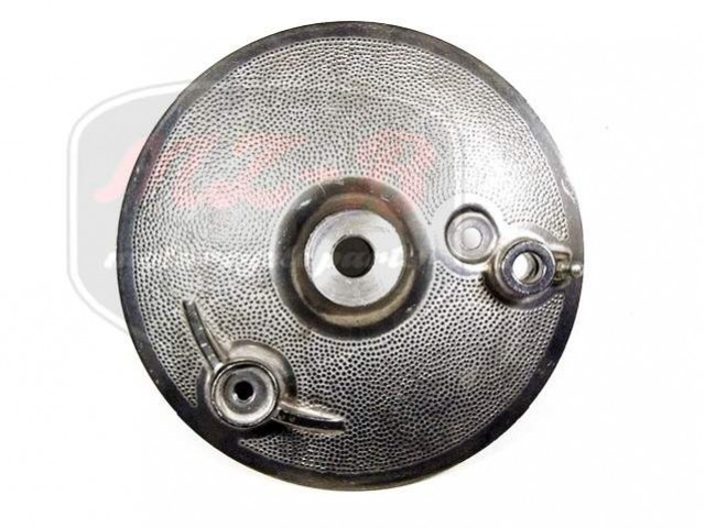

Postby Kruh » Sun Feb 07, 2021 11:04 am
I feared that was the case.
But just to clarify, are you referring to this type on the photo bellow or the older type with the extension for the torque arm?

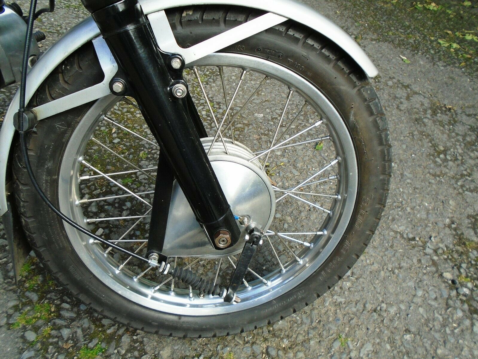

Re: MZ TS250 Front Brake Upgrade!
Postby dave47 » Sun Feb 07, 2021 11:52 am
I was referring to this type from an ETZ250, and comparing it to those on the TS250/1. I've got a supa5 brake plate on my ETZ at the moment.

Postby Kruh » Sun Feb 07, 2021 12:47 pm
I see. Thanks anyways.
I had the newer type in mind. That type is from later etz 250 models I assume, or maybe the 150. At the very least seems the 251 had it.
In any case, that one seemed narrower to me on the photos. But its very likely its the same width.
Does anyone maybe know about that newer type? If its from the 150, is it even the same diameter?
