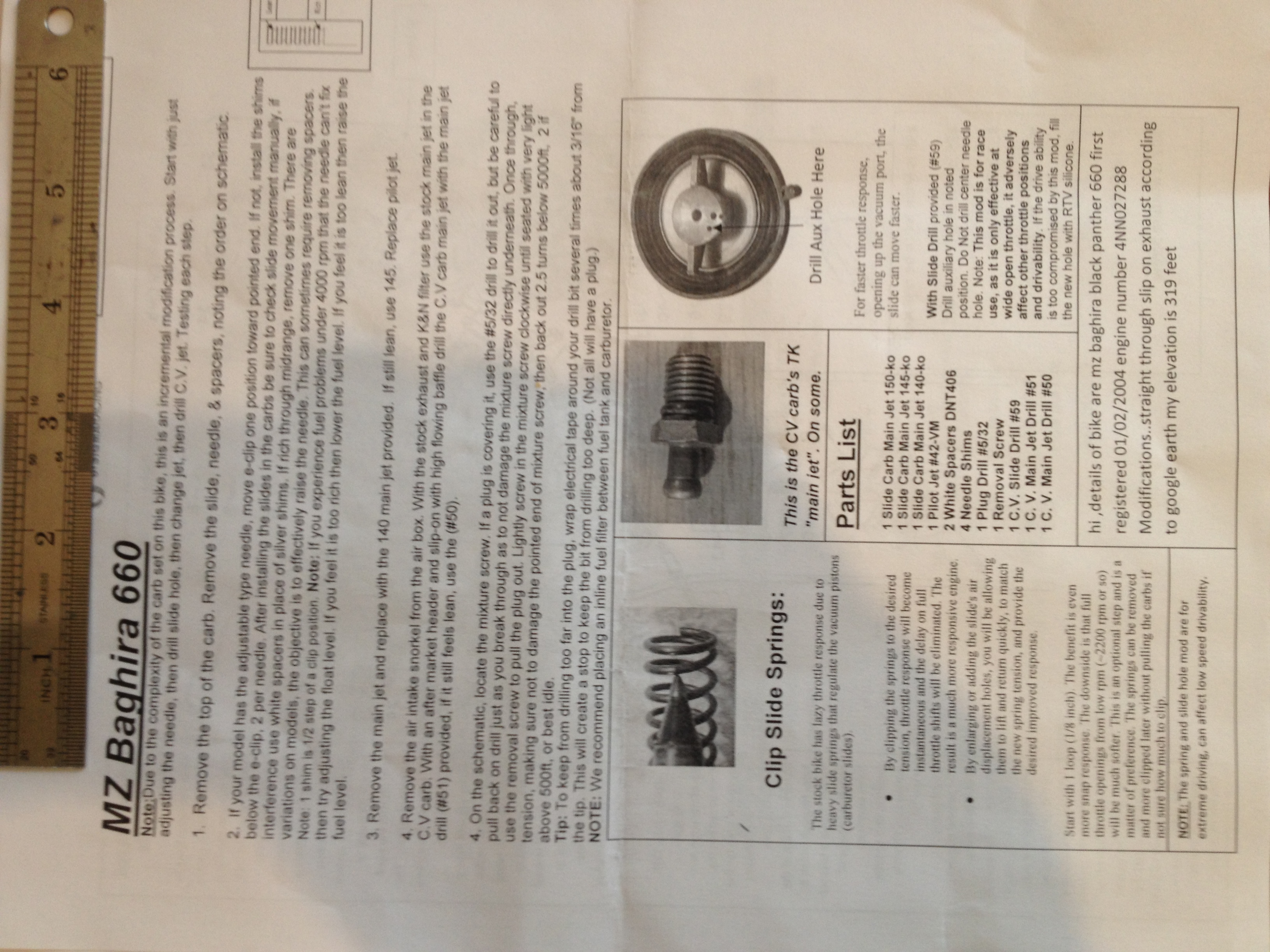

Postby den » Sun May 25, 2014 3:27 pm
so i done it and gone and bought a sigma kit,,,arrived today. The jury's out on this one.including postage i paid about £40.
so what s in the kit ,, well just jets and drills,,was it worth it ,, you be the judge of that,,
slide carb main jet assortment.140/145/150.used number 140
1 pilot jet #42-vm
2 white plastic spacers,,not needed.moved clip one slot towards pointy end
2 needle shims,,not needed. moved clip one slot towards pointy end
1 plug drill for air screw access,not needed for me. done it earlier
1 cv slide drill,not used,race only..clip off two turns of cv spring
2 cv main jet drills,#50.#51. used #50 with fingers not power drill
now turn air screw out 2.5 turns
so its not a science here,, in the instruction manual it says if its rich or lean change main jet or move needle position or adjust air screw..
its still going to be guess work , low range problems=pilot/air screw..mid range is probable main jet, full throttle could be needle position,,
who knows.
sigma jet kit for baggy 660

Postby den » Fri Sep 12, 2014 12:16 pm
Gobsheen wrote:How did things end up Den?
well i'm noticing the end of my exhaust is sooty,,mixture maybe,,ive put the needle back in the second carb to standard notch because of erratic rpm,, need to tune in then the second carb where it engages because of lag,,overall,,all its done is stop the popping on engine braking..50 pence jet would have done that,.my bike hates it around town , thats why i got the kit ,it loves first gear but uses it up quick ,put it in second and it just wants to speed up ,try third to coast along in traffic and no way,,just hates it , bloody bikes like a racehorse,, just don't understand slow trotting ..
