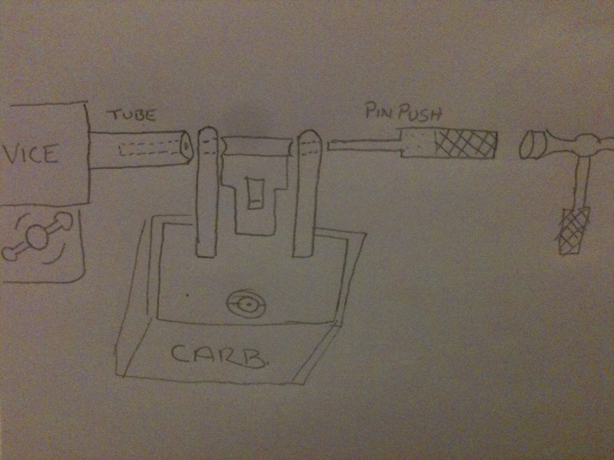

I here you with the float valve pin , I know one wrong move would knock the posts off and ruin a good carb,a tip if you get brave , what i did when i do mine is,, 4 hands needed.. I use a bar with a hole in the center ( tube ) -- I held this against the opposite end and tapped the pin through with a smaller pin , The idea is that the force from the hammer blow transfers through the pin,posts and is absorbed in the tube the opposite side ,
brace the end post before attempting to remove post pin
:idea:
Sorry if this is a "suck eggs moment " but it may help instigate a light bulb moment for the next person to attempt this .. :idea:

Postby den » Sat Jan 12, 2013 7:55 am
den wrote:I here you with the float valve pin , I know one wrong move would knock the posts off and ruin a good carb,a tip if you get brave , what i did when i do mine is,, 4 hands needed.. I use a bar with a hole in the center ( tube ) -- I held this against the opposite end and tapped the pin through with a smaller pin , The idea is that the force from the hammer blow transfers through the pin,posts and is absorbed in the tube the opposite side ,
:idea:
What i was trying to say in the diagram was that the opposite float assy post should be supported so as to illiminate drag from the pin and snapping the post off,,hense the hole in the tube to allow the pin to be tapped through into,
Im going to check the manual though , i also didnt relise there were arrow directions for removal , knowing me ive put it back in opposite anyways.

Postby breakwellmz » Sat Jan 12, 2013 1:37 pm
den wrote:I here you with the float valve pin , I know one wrong move would knock the posts off and ruin a good carb,a tip if you get brave , what i did when i do mine is,, 4 hands needed.. I use a bar with a hole in the center ( tube ) -- I held this against the opposite end and tapped the pin through with a smaller pin , The idea is that the force from the hammer blow transfers through the pin,posts and is absorbed in the tube the opposite side:
IF you had the facilities,it lends itself to a home made pin pusher.
I can imagine a short`U` section of metal(But squared off)big enough to fit snugly over the outsides of both pillars(Using washers) ,with holes inline with the pin,one of them threaded.
You could push the pin out with a small screw in the threaded hole,
without the pillars being loaded.
Putting heat on it with a soldering iron has GOT to be well worth doing,whatever you try.
I`ve not actually seen the setup,but i can picture it,i THINK!

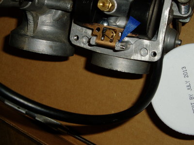

Postby OLDMTNCARVER » Sat Jan 12, 2013 3:19 pm
Just looked at the support posts that the pin goes through.
On the end of the one you might notice an arrow. FYI, I was wearing two sets of glasses.
